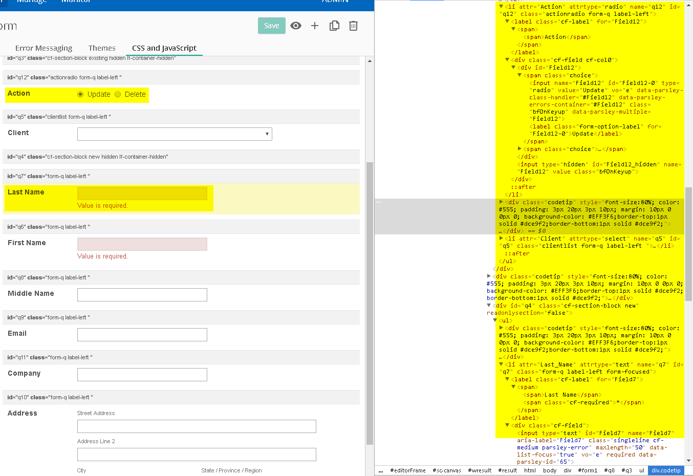

Unfortunately, these changes don't seem to do the trick. I took a screenshot of the form and dev console and highlighted the radio button + the first single-line field that should not be required if the radio button "Update" is selected.
Would any of the "parsley-..." classes be impacting things? Also, I noticed that the Last Name input tag in the DOM contains the word "required" hanging out by itself, not as part of a "class=" or "name=" etc. What type of attribute/value is the word "required" in this context?

replied on April 24, 2017
The parsley classes shouldn't be impacting it.  That's what highlights the fields in green or red when completed/missing.
Let's test to make sure your if statement is even executing as expected.
Within your if block, add something like this:     alert('if');
Within your else block, add something like this:     alert('else');
Then you should receive one of the two pop-up alerts, and we'll be certain which section of code is running.
If we can confirm that the if block is executing as expected, then we know we need to dig deeper into the code within the block.
Additionally - are you pre-setting these fields as Required from the layout page?  If so, you probably don't want to do that.  When you are using Javascript to impact things like required or read-only status, it can get messy when you have settings being tweaked on both the Layout page and the Javascript - so it's usually best to leave it unset from the layout page.
