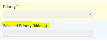

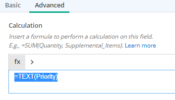

This worked for me when a dropdown option (Emergency) was selected from a list generated by a lookup.  I wanted the submit button to be hidden if Emergency was selected as a priority.  Tried many different options and could not get anything to work until I tried what you see below.
____________________________________________
I created a hidden single line field (aka #q71)
______________________________________________________
and had a calculation set up to populate the field with the results of the dropdown based on lookup (Priority).
Then referred to the hidden field instead of the dropdown.  Using the sample above, I came up with this:
