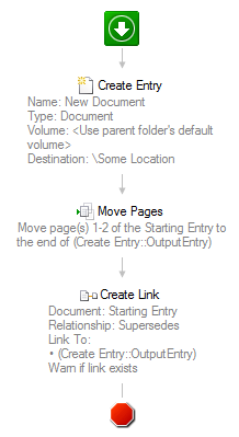

Sample Workflow Attaching Link:
This method would work but it does not seem that it would be very efficient. Does anyone have any suggestions or alternatives to solve this problem?

replied on April 20, 2017
Could you do everything in Workflow (create new entry, move first two pages from the source entry to the new entry, and link the two entries together)?
So if this wouldn't depend on some conditional starting rule, you could make it a business process. That way, an appropriate user that's logged into the Windows or web client can select the entry in question and run this business process on the document. By doing so, Workflow will move the first two pages of that document to a new document and then link the two documents together. Would that work for your needs? If not, can you clarify further how you envision the process to work out?
Thanks Alex. Yes, running it as it business process would solve the problem. Thank you very much.
