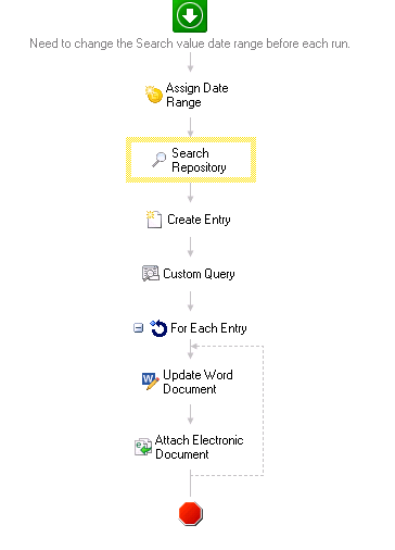

Query is now within the "For Each Entry" activity, and I have added parameters. On test everything works fine and things are being found (even several rows down) but on run those rows aren't populated.
I can get only the first row to populate, the others under default to the merge field code:
Any ideas why this might be?

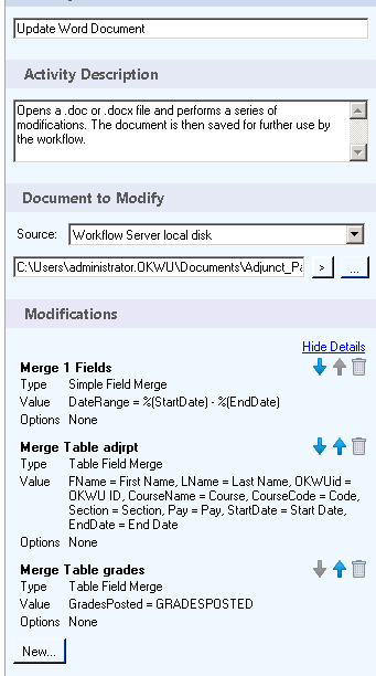

Can you attach a screenshot of how your​ Word activity is set up?
replied on April 21, 2017
The Merge 1 Fields is a simple heading for the document.
The Table adjrpt is the table with most of the information from Search, per row that is functioning correctly.
The Table grades is the table that is not working as it should, from Custom Query. Custom Query test works without issues so I don't think it is the problem.

Hi @████████ any thoughts on this issue? My custom query is supposed to run under each entry (based on a search that returns 19 entries for example) action and return Yes/No depending on the query logic if the grades were posted or not. The problem is that the Word document only gets the first entry for grades.
