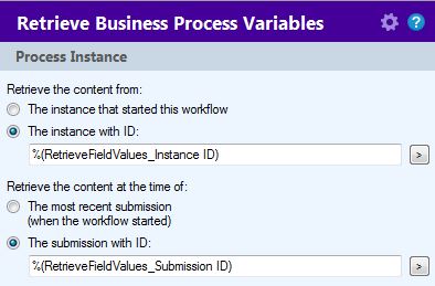

@████████ you could store the form with Instance ID and Submission ID as field values.  Then you can change how the retrieve forms activity accesses the data.
Click the gear to get the advanced config:
Then manually set the instance and submission id:
replied on April 18, 2017
Somehow, I have not yet ever noticed that gear and realized that there are more options.
Thanks for the help with this.

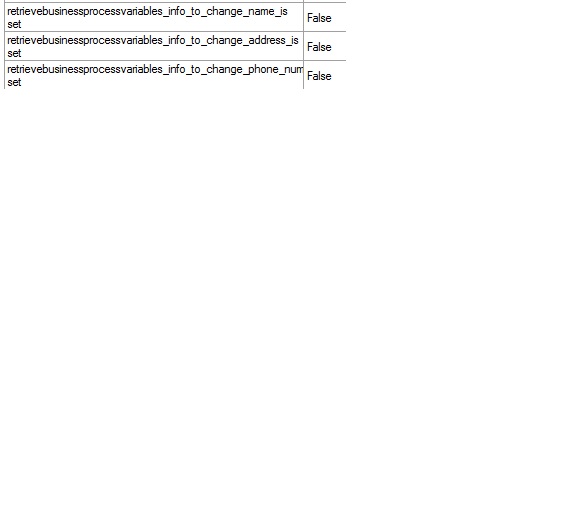

replied on April 18, 2017 • Show version history
@████████ Going back to your original answer, I'm still having a hard time getting workflow to recognize that the 'Name' Option is checked.  It keeps returning false.
Do I need to make an change on my form somewhere to save the value of the check or something?
(The other two options for address and phone should be false, as I'm not checking them in my testing)
Perhaps I'm setting the Instance and submission ID's incorrectly?

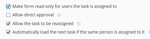

I think I found my issue.  The form process was simply one form, that was read only the whole way through.  The employee would submit the form, and then HR would view it.
I had been assuming the process ID and submission ID fields would populate at the save to repository task.
I changed the process so the HR employee views a different form, but everything is read only.  That allowed forms to populate the fields needed.
