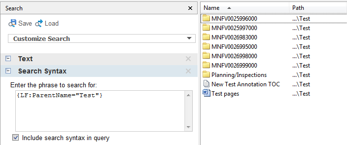

replied on April 17, 2017 • Show version history
Oh, sorry, you need quotes around your %(MemberNumber) token as well.
Note that all these entries are inside a folder called "Test":
I was wrong, ParentName is a valid search term. But you could also just make the search {LF:LOOKIN="main\Credit Union Member Information\Member Files\%(MemberNumber)"}

But it looks like the error I was getting was because I was still including the Type="F" part of the search when I changed from Name to ParentName.
Here's what I ended up using:
{LF:ParentName=%(MemberNumber)} & {LF:LOOKIN="main\Credit Union Member Information\Member Files"}
