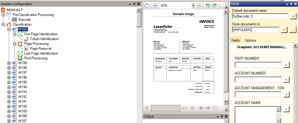

Or if you need each barcode value in its own field
replied on April 10, 2017

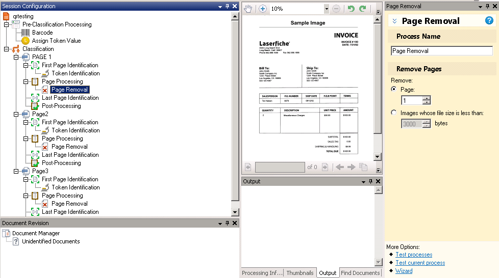

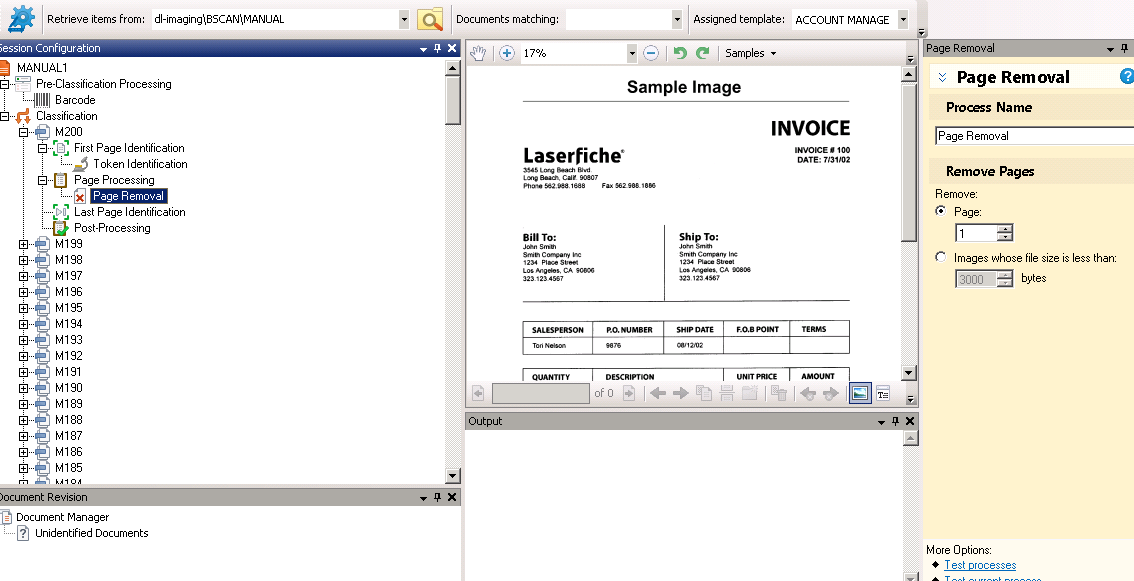

In either the page processing or the storage processing, you can add a page removal task and set it to remove first page.

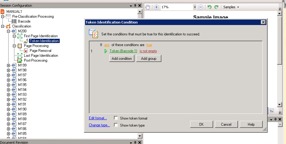

Multi first page conditions are called classifications. you can select an identification page for your barcode and indicate that the length of the document is until new identification is made (new page with barcode). you can create your tokens based on the information on the barcode on the pre-classification section and then based on those tokens, you can run one of many classes that could do completely different procedures and as Bert indicated before the firs step can be to remove first page (the barcode page).
How is each document behind the barcode handled?  Can you use the same naming convention for all?  If so, then your first page condition will be to have a barcode value that is not blank or empty.
Otherwise, can you split the document on the barcode with Quick Fields and put the barcode data in the name of the document and then let Workflow handle the rest.

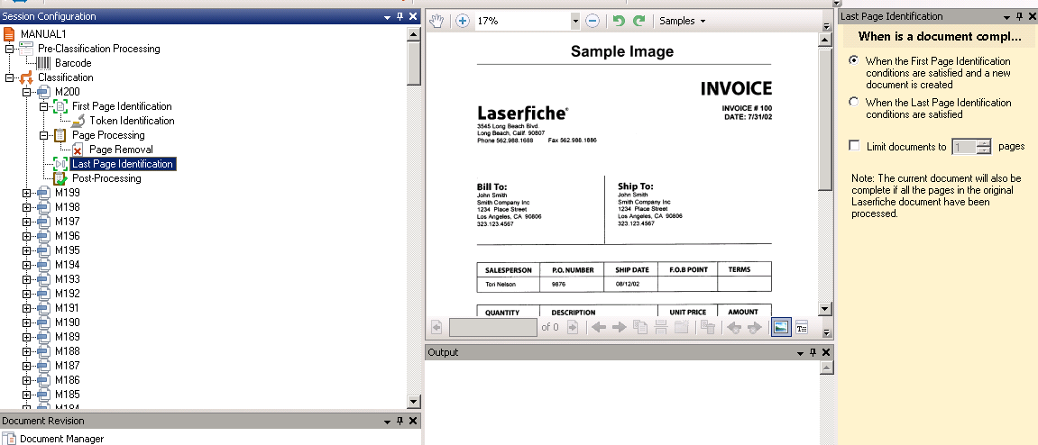

If at all possible, use a single class and put the barcode in the first page identification instead of the preclassification.

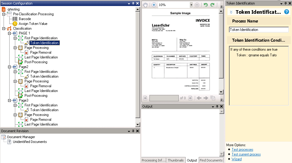

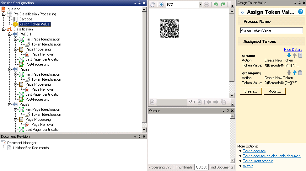

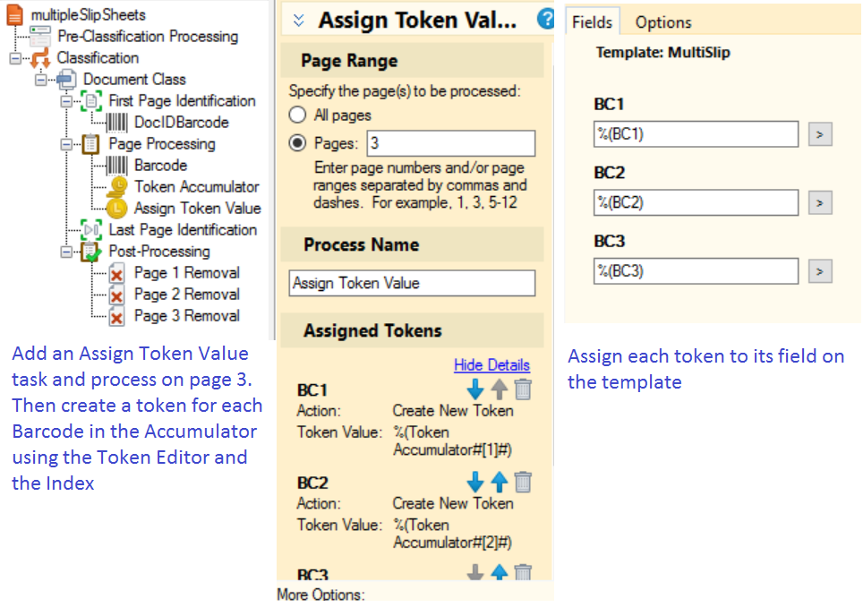

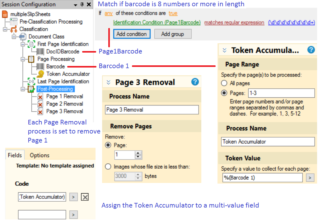

OK, I was missing the fact that you said you were leading with 3 barcoded sheets before each document.  You will need to use a Token Collector to catch the barcodes from the first 3 pages.
Hopefully you can follow this sample session:

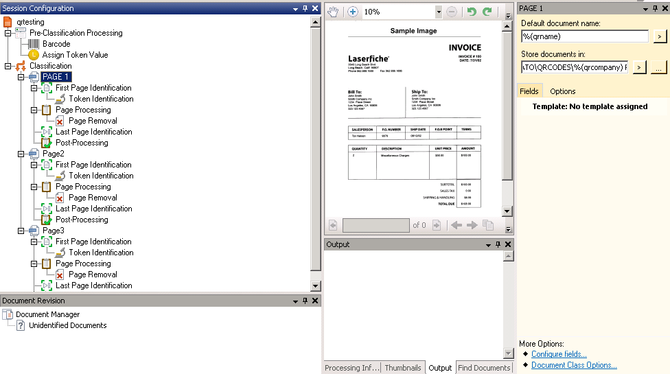

Thank you very much Bert Warren.

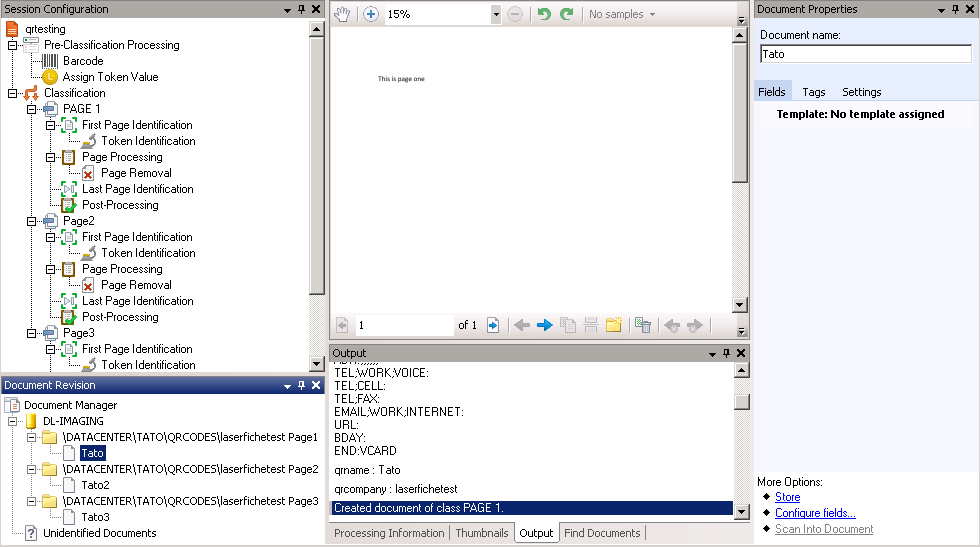

replied on April 13, 2017
Please see attached. I have done a quick quickfields session and added a quick document with the barcodes. this should show you more or less the steps. Change the extension of the qrtesting.txt to be qrtesting.qfx
