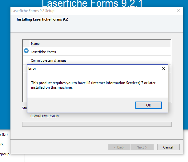

This product requires you to have IIS 7 or later installed on this machine
asked on April 6, 2017 • Show version history
I am seeing this error while installing Forms 9.2.1.1088.  I need this version of forms because it matches the version we are running on our server.
Has anyone seen this or know why it doesn't see IIS 10 on the computer?
replied on April 6, 2017
This is a known issue for version 9. See KB 1013672 for the workaround.
Thank you for the quick response.  This worked perfectly.

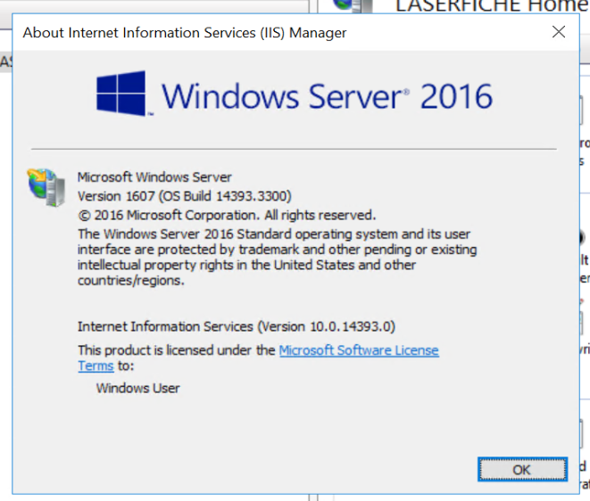

replied on July 14, 2019
I cannot reproduce such issue when i install Forms 10.4.1.172 on fresh win2016 VM, and IIS version is 10.0.14393.0.
See https://www.screencast.com/t/kCbdictG
replied on July 15, 2019
Hi Wenjuan; strange - I was definitely seeing the issue at the time.
However, my installer version was Forms 10.4.1.164. IIS is the same as yours. Perhaps it was only with that version?
replied on July 16, 2019
There should be no difference for SetupLf.exe between Forms 10.4.1.164 and 10.4.1.172, and I also try to install Forms 10.4.1.164 on fresh win2016 VM, it still works well.
replied on July 17, 2019
Odd. Thanks for checking, but must've been something unusual in my VM.

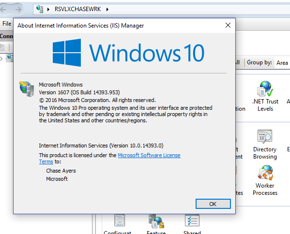

replied on October 23, 2019
Hi Wenjuan; I just saw this issue again (and the same resolution worked) when installing DocuSign and LaserApp 9.0.2 integration from the latest 10.4.1 installer file.
Details:
