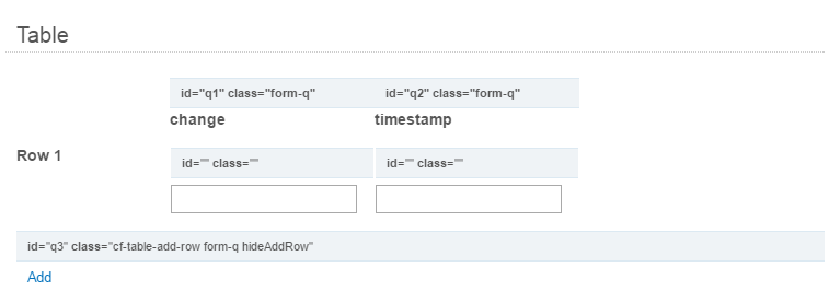

My customer has a table in Forms in which you can add rows.  There is currently only one column but they would like to add a second column that captures the date/time of entry change for each field in the corresponding row.  I found this answer that looks like it would work for field outside of a table (thank you Xiuhong!)  https://answers.laserfiche.com/questions/67971/Inserting-local-machine-Time-into-Forms-Field#68207 I need to modify this code to be applicable to a table.  Is this possible?

please see this. it shows it working. I have added the modified (added the document ready section)

Fixed the code. Had to do delegated events so that new rows added would calculate as well. here is the changed code. Sorry for any confusion.
