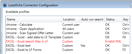

replied on April 6, 2017
Hi,
Many thanks for your reply.
Is the query line below in the format you suggest?
<Attribute name="LFQuery" value="{[]:[Vendor Name]="*%(CustNum)"}" />
After saving the change the Configuration panel displays Invalid XML as shown in the image below.
I must have made a mistake with the quotes position.
Could you please provide the correct query syntax.
many thanks
