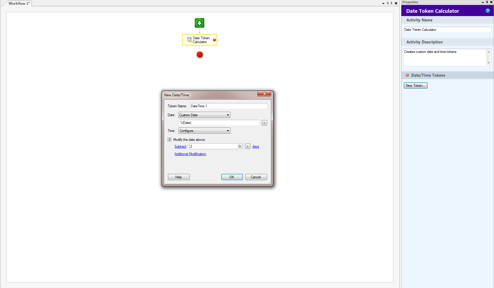

You can use the Date Token Calculator along with the global %(Date) token to create any range of dates you can then use in the Search Query.  So the search would be {LF:Created>="%(DateTokenCalculator_DateTime 1)"}  for all created in the last 2 days or remove the ">" and make it search for only the created 2 days ago.

I have the Date Token Calculator as Subtract 1 days and the code looks like {LF:Created<="%(DateTokenCalculator_1DaysAgo)"}
