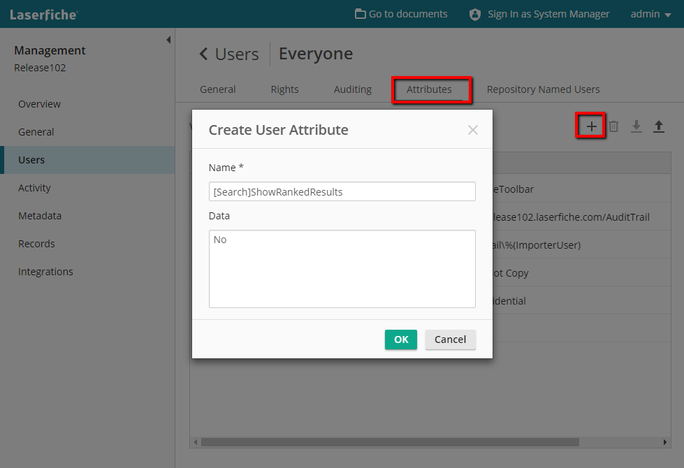

@████████Set [Search]ShowRankedResults to No.

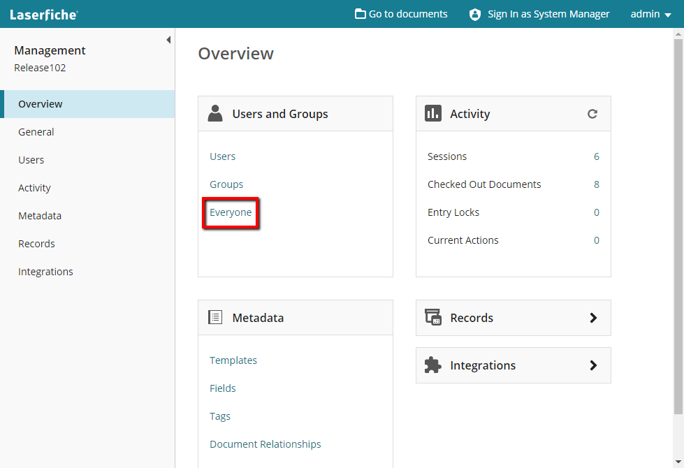

From the Management page, go to the Everyone group and add a new attribute:
