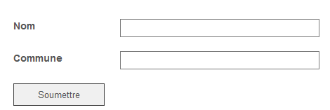

Hi all,
I make a form under Laserfiche Form 10.2
I need to put the field "nom" (1st one) as readonly using javascript.
This is my code
As you can see, I can modify the field.

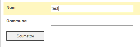

I created a new form using Laserfiche From v9.2 and I have no difficulty ; I cant modify the field "test".
Is it a bug or do I need to do something on the version 10.2?

This is my field
So this is my code
$(document).ready(function ()
     	document.getElementById("Field8").readOnly = true;
The id must to be like that "Field+number". Under my exemple, my form's Id is "q8" so my number is "8".
