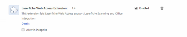

Good Day,
I have a strange situation where out of a team of 6 x Web Access users, 1 x Web Access user is not able to drag and drop the document into an *Incoming folder. Security rights are all the same as well as the Laserfiche Web Access Extension. All the users are using Chrome. It is not working on Microsoft Edge for her either.

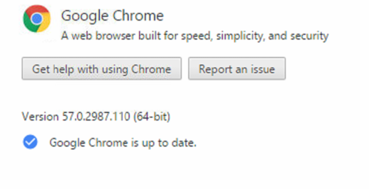

I reinstalled Chrome and the extension. No luck.
Any ideas or suggestions as to fix this error? Supporting images below:
The user is running Windows 8.1 Pro
