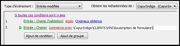

But if I add new condition "Entry path begin with <value>" my workflow doesnt work.

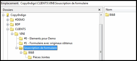

The entry is "Enregistrement de la société B&B" from
"\CopyrIndigo\CLIENTS\VINI\Souscription de formulaire\B&B\Enregistrement de la société B&B"

Your Starts with value should not have the repository name in it and should look like:
Entree: Chemin commence avec \CLIENTS\VINI\Souscription de formulaire

Try removing the "\" in front of the Path "\CopyrIndigo\CLIENT....." so it starts with "CopyrIndigo\CLIENT....."

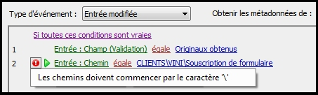

I cant
Sorry, I deleted "\CopyrIndigo" whereas "\" but the result is the same

Your path is not supposed to include the repository name. It should be "\CLIENTS\etc." not "\CopyrIndigo\CLIENTS\etc.", "CopyrIndigo\CLIENTS\etc." or "CLIENTS\etc."

I tried "Entry path starts with \CLIENTS\VINI\Souscription de formulaire" (without the Repository name) and my workflow didnt start anymore.
I have no error message ; it just like my conditions are wrong.

Actually, my entry is in "\CLIENTS\VINI\Souscription de formulaire".
I want to trigger the workflow when my entry is in "\CLIENTS\VINI\Souscription de formulaire" and my field [validation] is changed. The action is moving the entry from "\CLIENTS\VINI\Souscription de formulaire" to "\CLIENTS\VINI\#1 - Formulaire avec originaux obtenus"
