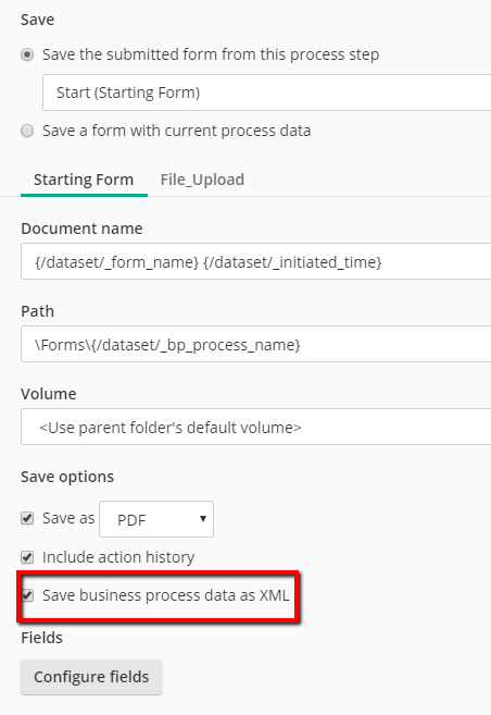

Hi Zane, the format for date/time field variable is different from the initiated_time, for date/time field variable as you referred in the screenshot, the conditional expression is "/dataset/Date>"2017-08-04 09:45:00". An easier way to know what the expected value in the conditional expression is to add a "save to repository" service task and check "save business process data as XML" and check the format of the values in the XML saved.

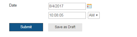

replied on August 4, 2017
I have just now started testing this, but it's not working.
Here is my outflow condition language in my exclusive gateway:
/dataset/Date>"2017-8-4T09:45:00.000Z"
Which should divert the the process to terminate, otherwise the process should continue.
Attached is an image of the field "Date" as it is set in the form.
replied on August 7, 2017
replied on August 8, 2017
Thanks, for the answer and the tip on writing the XML for field formatting info. I'm sure I'll use that in the future. Your date formatting worked great.
