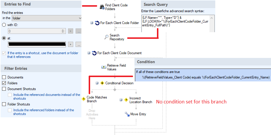

replied on July 18, 2017
It may be slow running because it will run a search on each Client Code folder, but I would run a search to get all the Client Code level folders.  Then in a For Each loop, run a search for all documents within the the current loop entry.  Then you have another For Each loop that checks each entry returned.
replied on July 23, 2017
That is perfect Bert, I used your setup to create what I required and initial testing works perfectly. I also now added a date calculator to make sure it does not pick up every document every night and only target the date it is running so it only targets a small number of files.
