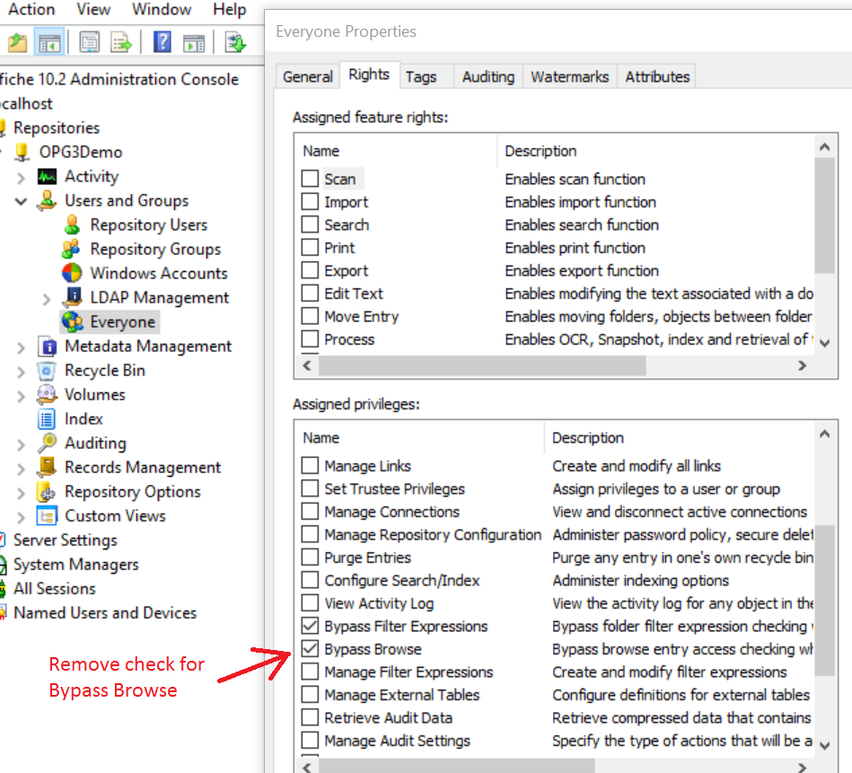

If you are having users see folders, but they cannot open them (do not have access permissions) and you do not want to see the folders at all, go to the properties of the everyone group in the LF Admin Console and remove the Bypass Browse Privilege.

       Thank you for the quick response. I know how to set up and give access to a user. I need a more in depth knowledge of how to limit a user to a single folder. I have 1100 folders in my repository but I only want them to be able to see just one of them. Everything I have tried still allows them to see all of the folders in the repository.
replied on March 22, 2017
I will test this out right quick
That's it! Thank you so much. I hope you have a great day!!!
