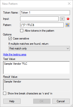

Hi Melanie, this should do the trick:
(.*)? \*FLC$
A breakdown of the syntax:
  • ( ... ) : specify the character set to match and capture
  • .* : match any amount of any character
  • ? : non-greedy specifier; because we're matching any character, we use this to make sure we don't inadvertently match any character. For this particular pattern, it's not strictly necessary but I find it good practice whenever using .* in the pattern.
  •  \*FLC : the pattern to identify at the end of the string; note that we use \* to escape the asterisk
  • $ : match the end of the string. This will make sure if, on the off chance that there's a " *FLC" somewhere that you do want to capture, that it indeed gets captured.
Hope this helps!

Thank you so much for a perfectly explained answer!  This worked great, and it helped me to understand more about how these items work in combination.
