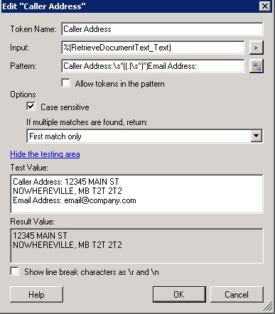

I've got some text in multiple lines that I want to capture. Using the 'testing area' I'm able to see that it should process fine. However, when I run the workflow, it gets stuck at this pattern (I had all the patterns in one pattern matching step but split them out to see which one was causing the issue).
The workflow will never terminate, it will stay 'running' but will never do anything past that pattern.
The pattern regex is: Caller Address:\s*((.|\s*)*)Email Address:
Test text is:
Caller Address: 12345 MAIN ST
NOWHEREVILLE, MB T2T 2T2
Email Address: email@company.com
Result value shows: (which is perfect)
12345 MAIN ST
What am I missing here? Issue with WFS?
Thanks in advance for any help.
