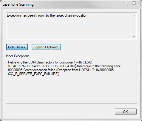

Regarding the selection, I click on the TWAIN Scan source
and Laserfiche freeze for a minute and I am receiving this message.

Then I would say it is time to uninstall and reinstall the LF Client and LF Scanning.
replied on March 20, 2017
I have reinstall the LF client and LF scanning that is part of the LF client installation.
Same issue. I snapshot the exception error when I choose the TWAIN.
