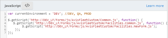

The JavaScript is kept in a .js file stored on the Forms server and referenced in the forms as follows under the CSS and JavaScript tab of the Form.

We found the problem.
It turns out that the one developer working on the process had added references to the view fields (_FormsLayout.cshtml and _Layout.cshtml) so that they would load by default and not have to be implemented in each Form created. So when we did the Upgrade those files got replaced with the default ones resulting in the behaviour we experienced. Once those references was put back, all the scripts worked like before.

While there were some changes to how custom JavaScript is executed in Forms 10.2, I don't have any issues using $.getScript and using functions defined in custom files saved to a subfolder of /Forms/js.
Building off of what Xavier had mentioned:
  1. If you type in the URL http://DEV_LF/Forms/js/AvisFleetCustom/Common.js into the navigation bar of the browser, do you indeed get the JavaScript file back?
  2. Are there any errors in the browser console (F12 > Console) when loading the form?
  3. You can use the followng code to further debug $.getScript :

I tested with similar script with Forms 10.2 update 1 and popup is a function defined in testapi.js, there is no problem to execute it.
    $.getScript("http://v-sh-lf102/forms/js/util.js",function(){
     $.getScript("http://v-sh-lf102/forms/js/util.redirect.js",function(){
    $.getScript("http://v-sh-lf102/forms/js/testapi.js");
  $('#q92 input').on('click',clear);
  function clear()
  popup();
Where is the blcokUI defined in your script?
