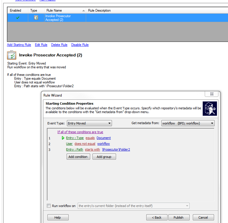

I have a process that when a user is done reviewing documents in Folder1 they drag Folder1 (with the docs) into Folder2.  Once Folder1 is dragged into Folder2 I want workflow to process the documents in Folder2 (And deleted the parent folder when empty).
I'm having no success with a workflow's starting rules to process the documents in Folder1 once it becomes a subfolder of Folder 2 .  I can drop documents in Folder 2 and they process fine but when Folder1 is a subfolder in Folder 2 nothing happens to the documents in Folder1.
I have changed Entry : Path to "starts with", "is in" and "equals".  Nothing works.

Hello John,
The condition "Entry: Type equals Document" will prevent the starting rule from triggering on a folder. If you want the starting rule to just work on folders, then "Entry: Type equals Folder" will work.

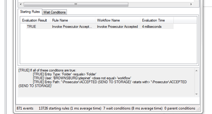

Ok I made that changed and it did correct part of the issue - my starting rules are satisfied.  Thanks

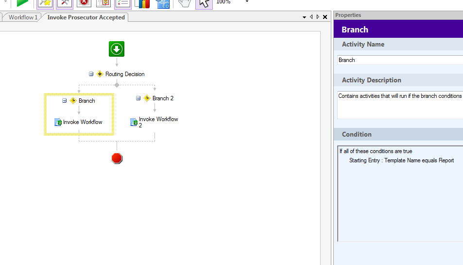

But now my invoke workflow that needs the template from each document in Folder 1 does nothing - docs don't move.
replied on March 14, 2017
Since you are now starting the workflow one level higher, you'll need to get those documents with Find Entries and then use a For Each Entry activity to go through them and check their templates.
