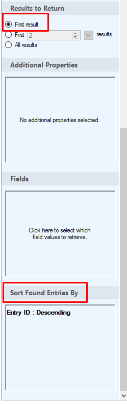

If you were in the Laserfiche Client you could then order by the Entry ID column to find the max. In workflow it's slightly different but can still be done. In the configuration of the "Search Repository" activity, set the following:
I think this is what you're trying to achieve? If not I might have misunderstood so sorry in advance!

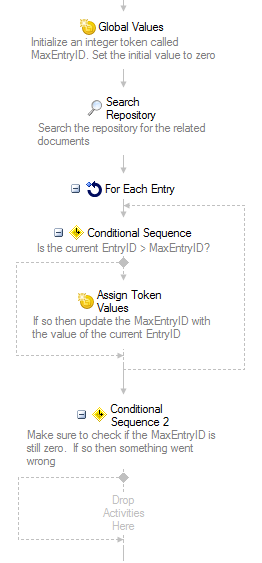

How about something like this?  It uses a 'global' integer token that is set to zero to start with.  Each loop through the search results compares the global token to the CurrentEntryID.  If the CurrentEntryID is greater than the global token then update the global token with the value of the CurrentEntryID.  Importantly, at the end of the process I would check to make sure the global token is no longer a zero.  If it is then something went wrong!  ;-)
Update: You can also check the value in the global token against the starting entryID to make sure the process does not return itself...
