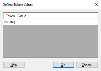

The WF is set to run each day, pull up "today's" newly created documents, and then for each one found, do a task for me.  But the Search Repository activity is not finding any documents.  When I try the "Test Search Query" it shows that the date token is coming up blank (takes me to this little window - see below) and then gives me this error message: "The search parameter is invalid. [9245]".  I have tried it without the quotes around the date token, as well; resulting in the same thing, just a different search error number.

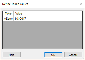

As for testing the "search repository" activity, you need to actually specify a date value to use for that token like below:

If I enter today's date in that Value spot, will the activity know to change it the next time it's run?  Or will it look for March 8th every day that it is run?

replied on March 9, 2017
When you're testing the activity, it will run the search against whatever date you specify.
When the workflow runs normally in production, it will use the whatever the current date is.
