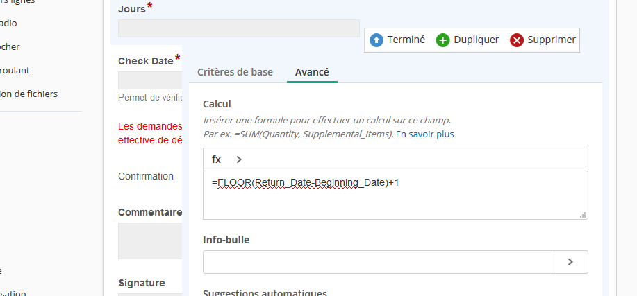

Hi Rui Deng,
I suppose this is a formula error but i'm not sure. What is the others ways?
Anyway ; i tried without success :
$('#q25 .formula-error-list').hide();
$('.q25 .formula-error-list').hide();
$('#Field25 .formula-error-list').hide();
$('.Field25 .formula-error-list').hide();
I still have the same error.
I used Calcul to get value.
=FLOOR(Return_Date-Beginning_Date)+1
Idk if this could help.

Hi Olivier,
Since it's formula error, you need to trigger hiding formula error when the formula reference fields change (they are Return_Date and Beginning_Date as your formula shows).
So the whole script would be like:
$(document).ready(function(){
  $('li[attr=Return_Date] input').change(clearFormulaError);
  $('li[attr=Beginning_Date] input').change(clearFormulaError);
  function clearFormulaError()
    $('#q25 input').removeClass('formula-error');
