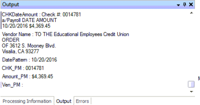

Hello Everyone,
I need a little help capturing one line of text in a large Zone OCR box that picks up multiple lines of text.
This example is what I was working with. I need to capture everything after TO THE but nothing on the next line. I used \r \n \s with no luck. Thanks for the help.

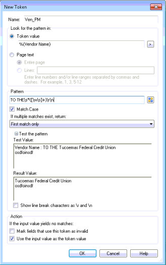

replied on March 1, 2017
Try \n\n. Zone OCR ends lines with 2 newline characters.
I gave it a try and if failed.
Vendor Name is the OCR box
Ven_PM is the pattern
whats really interesting is that in my environment, I can get the pattern to work.

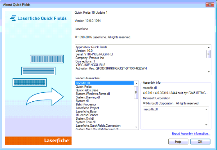

This is theirs;
Mine is 10.0.0.976.
I'm going to update them to the latest QF and see if that helps.
Just upgraded to the latest, 10.1.0.168
still getting this;
I added the \w at the end to see if that would help and it did not. The \n\n did not work at all. No match. I don't want to downgrade, what now?

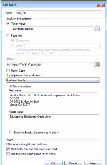

replied on March 2, 2017
I got it to work since I realized the next line text will always be ORDER. Built the pattern to match that and then \n worked. Not sure why it wouldn't work relying purely on the \n or \r.
TO THE\s*([\w\s]+)\nORDER
Thanks for the help everyone.

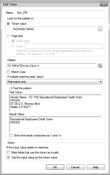

replied on March 7, 2017
Hello again,
My pattern stopped working because OCR for some reason decides to not read ORDER correctly and drops the OR. Since my pattern was looking for an O, it fails. I tried Alex's pattern and that one worked.
Alex, is there a good site you use to test patterns. I have been using regex101.com and changing it to single line and I could not get it to work exactly like QF acts. I copied the text from OCR and used your pattern and no match, but I run the session and it works. Any suggestions would be great. Thank you.
