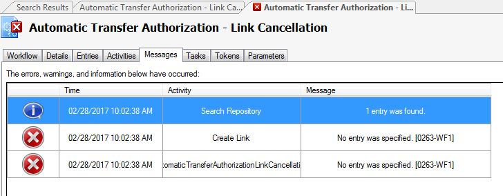

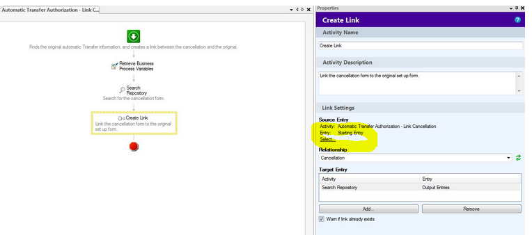

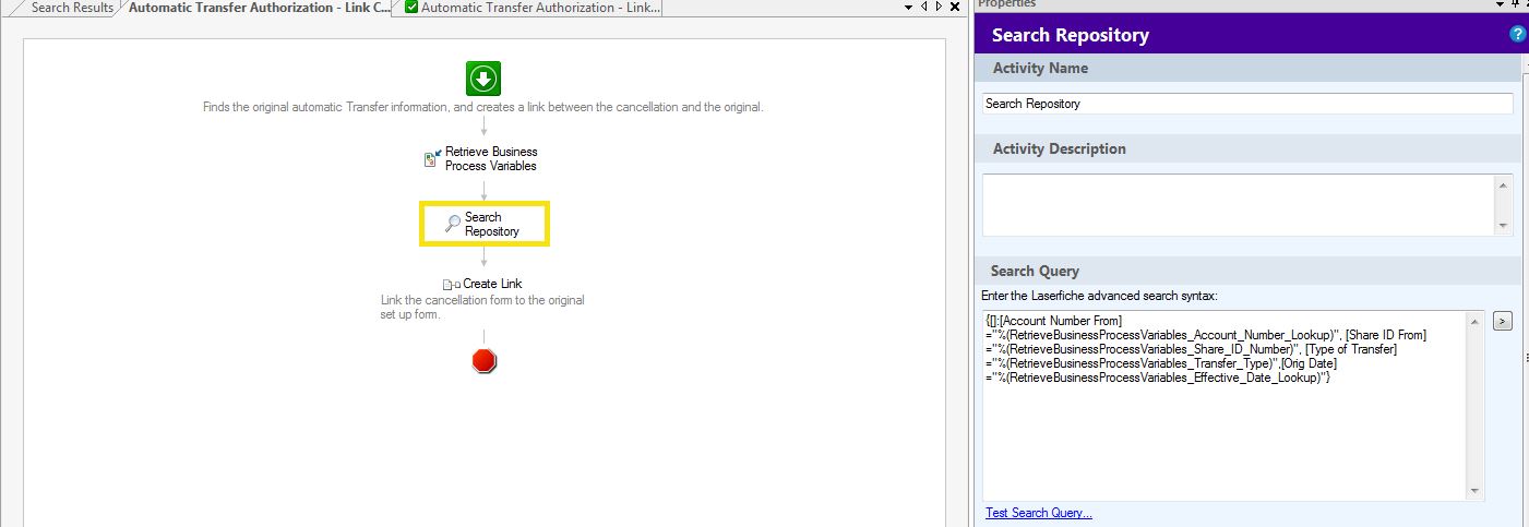

I'm betting I'm missing one little step in here somewhere.  I'm having trouble getting the create a link to work.  I've basically got my workflow set up almost identical to the tutorial video located at the Laserfiche help guide.  The only difference being I'm using business process variables to start things off instead of field values (this form is triggered by a Workflow Service Task in forms) and I've named the links to custom names, Setup and Cancellation.
My search finds the file I'm wanting, displaying "1 entry was found."  But then the Create Link step fails every time, saying "No Entry was specified."  Like I said before, I've got everything configured like the tutorial video.  Is there something I'm missing?  Is that tutorial video only showing a small portion?

replied on February 28, 2017
Evan,
It looks like you need to edit the Source Entry property of the Create Link activity to use the First Result property of the Search Repository activity.  In the image you provided the Create Link activity is still pointing to the Starting Entry of the workflow...

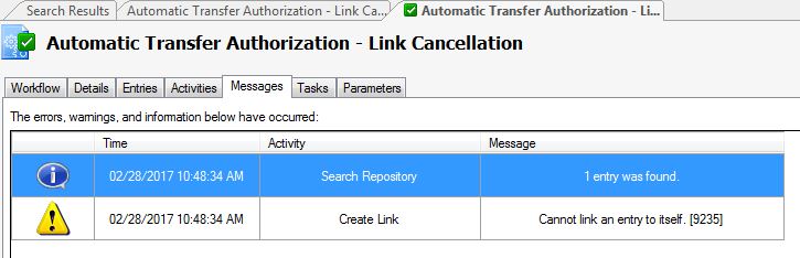

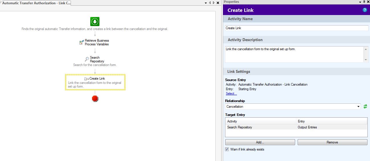

I made the adjustment, but have run into another error.  It brings up the message, "Cannot link an entry to itself."

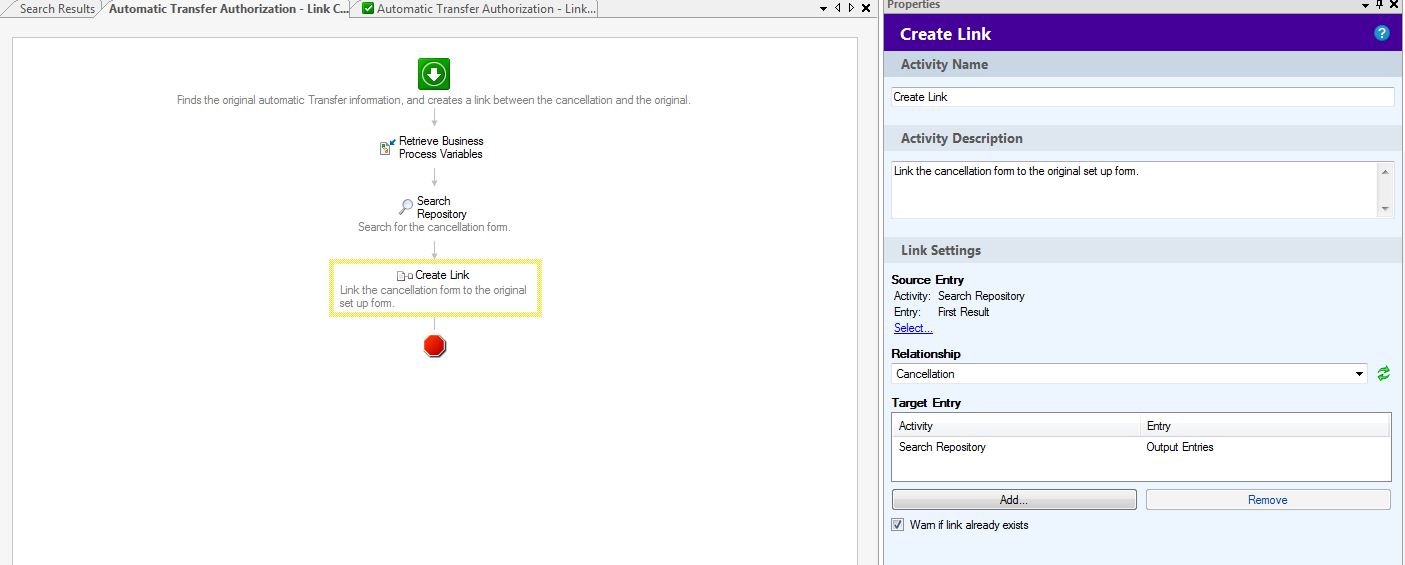

Attachment Capture 4 shows the error.  Capture 5 shows the updated settings to the Create Link Step.
Edit: My Repository search only brings up one result (by design), if that matters.

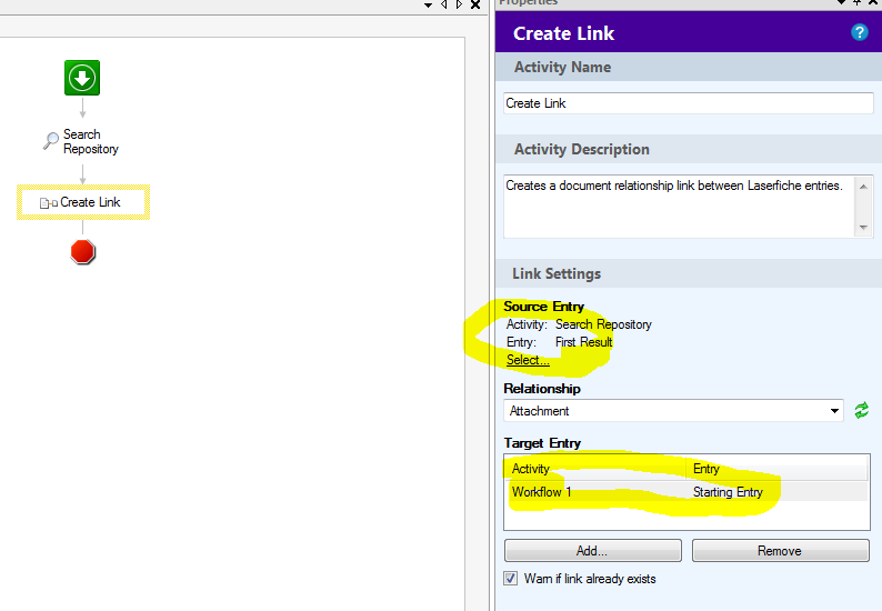

So the Create Link activity is used to create a relationship 'link' between two or more Laserfiche documents.  What other documents are you trying to link to the First Result entry from the Search Repository activity?
In other words if you are trying to link the First Result entry from the Search Repository activity to the entry that initiated the workflow then the Create Link activity would look like this;

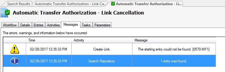

You're right. I'm looking to link the document that triggered the workflow to start with the document that is found with the search repository task.  Using your recommendations, it shows the error message of, "The starting entry could not be found."
I've tried to adjusting my forms process a bit as well, having the workflow be triggered before and after this document is saved to the Repository.  (The file I'm linking to what is found by the search)
Edit: both configurations of the form process produce the same error.  The only difference is the one way has the error show before the search result, like the attached screenshot, and the other way has the error show after the search result.

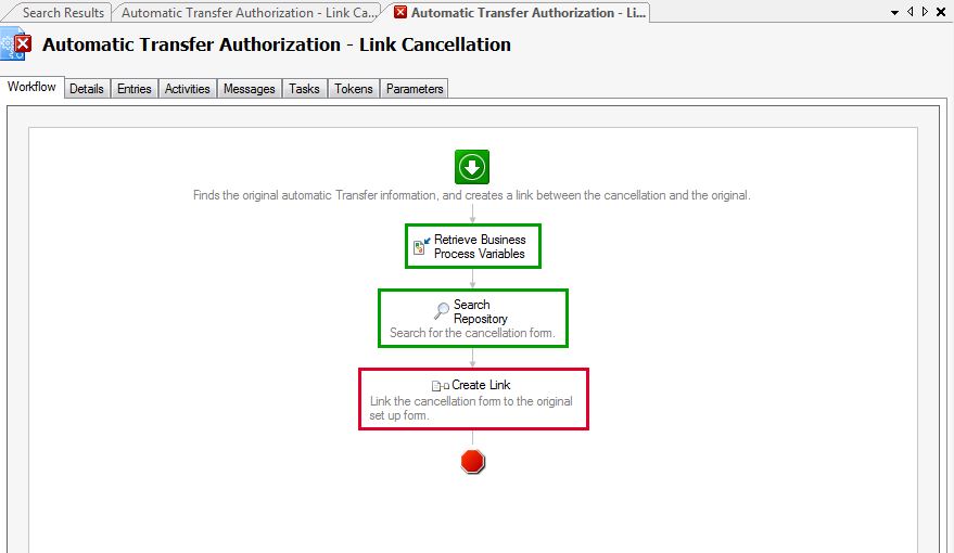

When I start the Business Process below on a selected entry in the LF client the end result of the workflow is a set of linked document (as one would expect).

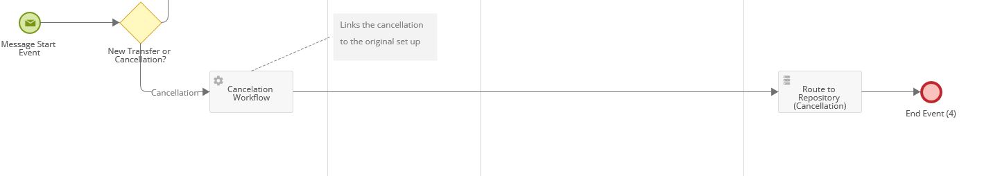

Essentially, the idea is that when a person fills out a form to cancel the automatic payment authorization, Laserfiche is meant to find the original setup agreement, and link the setup with the cancellation form.  When cancellation is chosen in the starting form, it follows the path found in the screenshot.
I get the same result of "The Starting entry could not be found" if I have the workflow and repository in the locations in the screenshot, or if their spots are reversed.

Using this info, I'm able to lookup and find the original new transfer agreement.  (That's the search repository step in workflow).  By using some info such as account number, date, type of transfer, and share ID, I'm able to filter it down to 1 result consistently every time.
