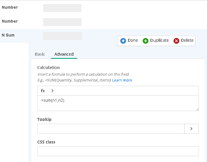

I have created a dummy form to see if I could use the calculations feature. This is my first time using it. For some reason it won't add the single line fields together.
replied on February 27, 2017
I believe that these functions will work starting with Forms 10.2.  For a Sum function, your field type will have to be a Number and make sure that you form your calculation statement using the variable and not the field label.  Ex:  Sum(n1,n2)

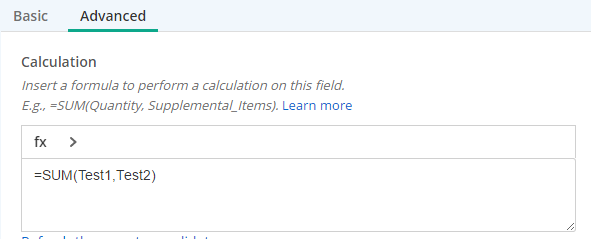

Calculations were supported beginning with 10.0. The issue you are running into is that the fields you are summing are Single Line fields and not Number fields as Glenn distinguished. The reason 1 + 1 = 0 for you is because per the OpenFormula standard, Text values become 0 when cast as a Number type, e.g. for addition, and values from a Single Line field are treated as Text types. So what's happening in your calculation is you are performing "1" + "1" = 0 + 0 = 0. If you change the field type to Number, you should be able to get it to work without needing to update to 10.2 (which update would not address the root of the issue at hand).
Edit: Actually, if you have at least Forms 10.1, you can use the VALUE() function to attempt to get the numeric value of a string representation of a number. For example, =SUM(VALUE(Test1),VALUE(Test2))
I would actually recommend not using this and instead use Number types for operands which you know you'll have to sum, because then you get built-in validation that only numeric values will be entered; if you try to evaluate, say VALUE("Hello") and use that in a sum, you'll get a calculation error.
