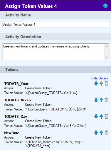

Have a date coming in as a numeric (YYYYMMDD).  Need to convert it to a MM/DD/YYYY to place into metadata for a document.  Can't quite seem to find the right WF tool to do the job.
replied on February 27, 2017
Literally a string of 8 digits?  I would try pattern matching in 3 sets to get the tokens.
Year - (\d{4})\d{4}
Month - \d{4}(\d{2})\d{2}
Day - \d{6}(\d{2})

replied on July 5, 2018
Drew,
Guessing there may be more than one way to accomplish this.  I ended up breaking the date field apart, then put it back together in the format needed (see Erik's suggestion above).
Mike
