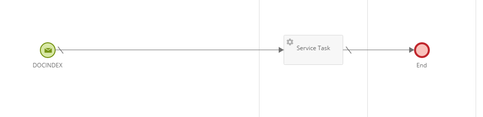

I have a laserfiche form that triggers a workflow. The form is configured not to wait for the process and its only purpose is to gather data for the workflow. The process was working fine until the upgrade to 10.2 and now the forms triggers two workflows. When I check into the Windows log I see the error "The call to Laserfiche Workflow API was not successful. (The operation has timed out.). [LFF5203-WFServerApiFault]".
I looked and there was a previous comment about this and it suggested to adjust timeout settings or re-submission on failure settings but I have not been able to find out where those are.
Again the forms process works without a single problem and the workflow does too the only problem is that when the workflow gets triggered twice, I find myself with duplicate entries.
