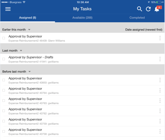

Not sure if 10.2 still has this same look but it would be nice to see a count of how many tasks and how many available tasks we have.
Ex: My Tasks (2) Available (1)

Hello Chynna! It was great to see you again at the conference! In 10.2 it does not show a count of assigned, available, or completed. However, below the header for this week, earlier this month, last month, etc... it does show a count. In Mobile, I believe it is showing a count as you would like to see in the Forms Web Client.

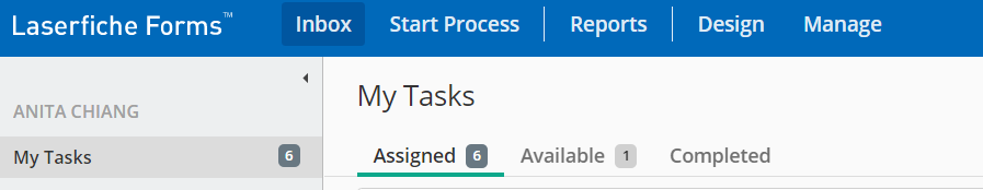

Hi Chynna,
The ability to show numbers in the headers is made available by the Laserfiche Notification Service and is shown below in the 10.2 interface. However, this should be available in Forms version 10.0+ as long as your notification service is configured!
