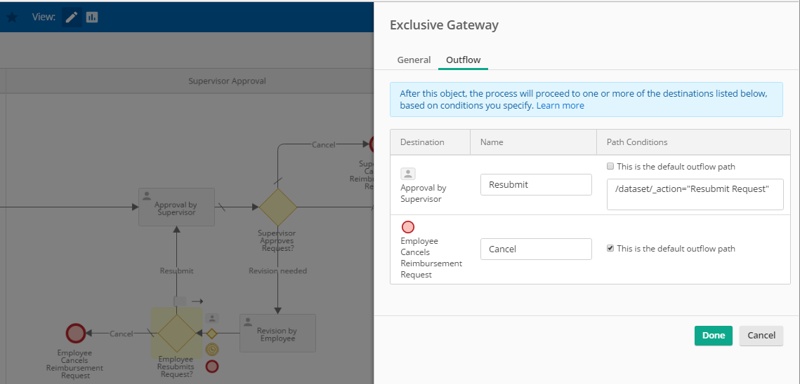

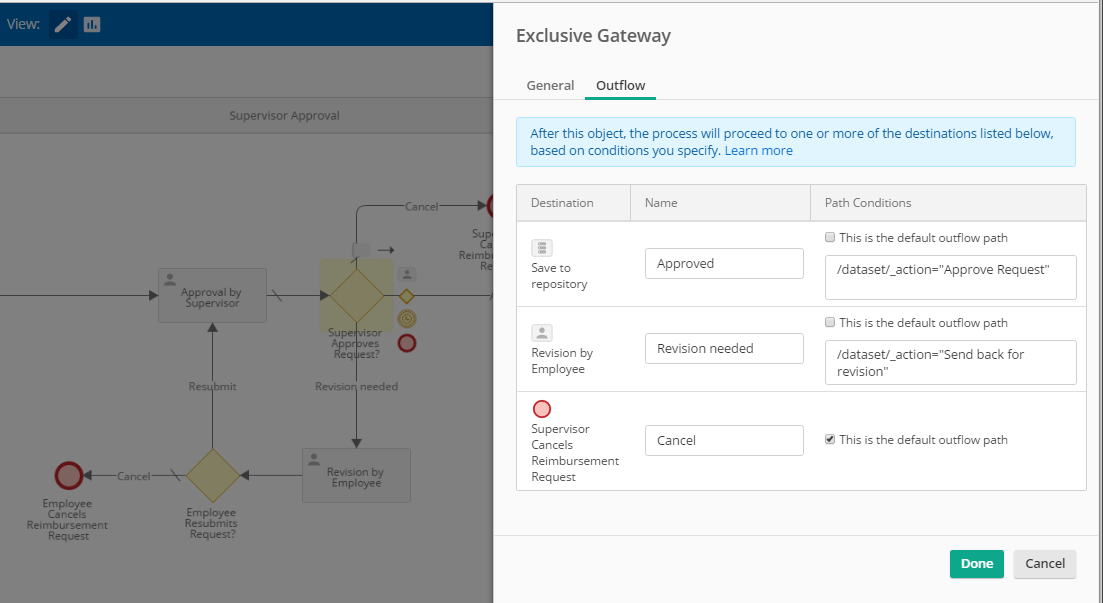

I loaded up this process from the BPL and ran through it a few times. I didn't encounter the same issues you had, regardless of whether I had the default "Initiator" user or hard-coded the "Forms" user for all the user actions and notifications. I've included a few screenshots below that show how the outflows from each of the Exclusive Gateways were configured just in case there might have been something off there.

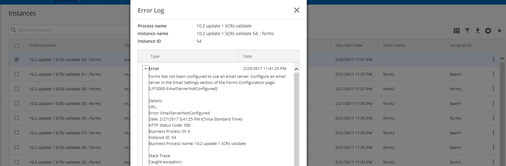

From your screenshot it shows the process has been completed, so please check the instances list of the process to see what the steps were processed after the "Approval by Supervisor" for this specific instance to see whether the conditionals are correctly set.
For the issue of no email was sent, you can check from the instances list by selecting that instance and click "View error log" to see whether there is any error.
