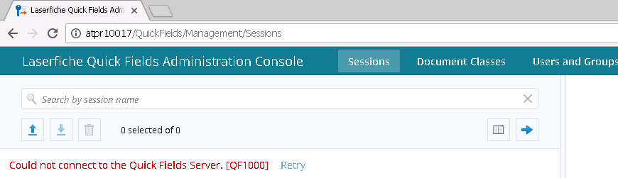

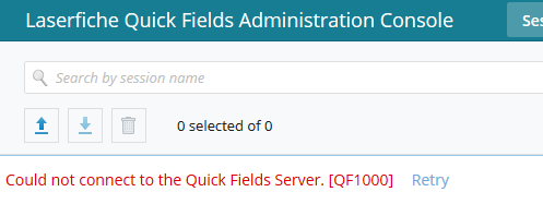

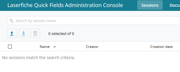

We recently updated to Quick Fields 10 several weeks ago. I noticed that we are not able to publish sessions or get into the Quick Fields Administration Console. We are receiving an error that states "Could not connect to the Quick Fields Server. [QF1000]". We have both ports 8092 & 8093 open. I am not sure where the problem lies and could use some help.

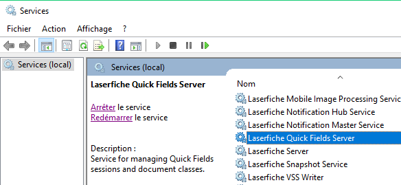

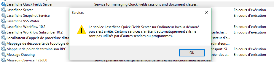

Hi all,
I found how to resolve mine.
As a reminder, my error is the same than Zach but for an internal network.
In my case, the Laserfiche Quick Fields Server' service didn't start and I can't start it.
1. Stop "Laserfiche Quick Fields Agent".
2. Start "Laserfiche Quick Fields Server".
3. Start "Laserfiche Quick Fields Agent".
4. Reload your Web Page.

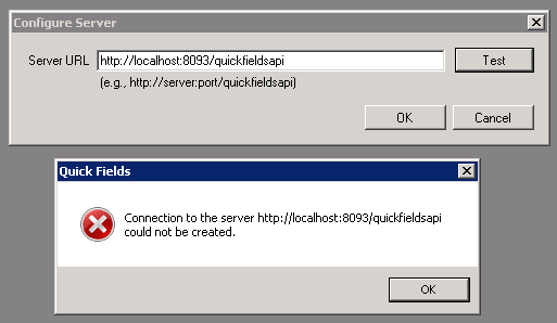

Hi,
I tried to follow steps defined by Oliver:
But I am still getting <Could not connect to the Quick Fields Server. [QF1000]>
Pls. help me.
Also, I cant connect to LF Quick Fields Scanning

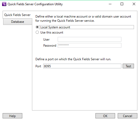

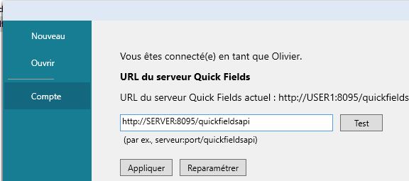

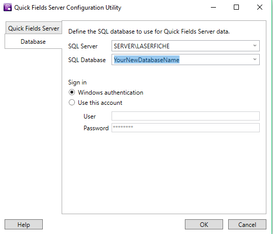

replied on March 1, 2018
Hi Mahwish,
I was the same error and my first solution didn't work.
QF Scanning was browsing to a QF Server that was running on another machine and couldnt changed it unless we stop the QF Server on the other machine.
This is another solution.
First, under QF Server Configuration Utility, change your port to another one (example 8095)
Then, on Database, create a new database.
Restart your service
Launch QF Scanning first
Ensure under account it is set (with the new port) and pass the test. Apply
Then launch QF Admin and that should connect.

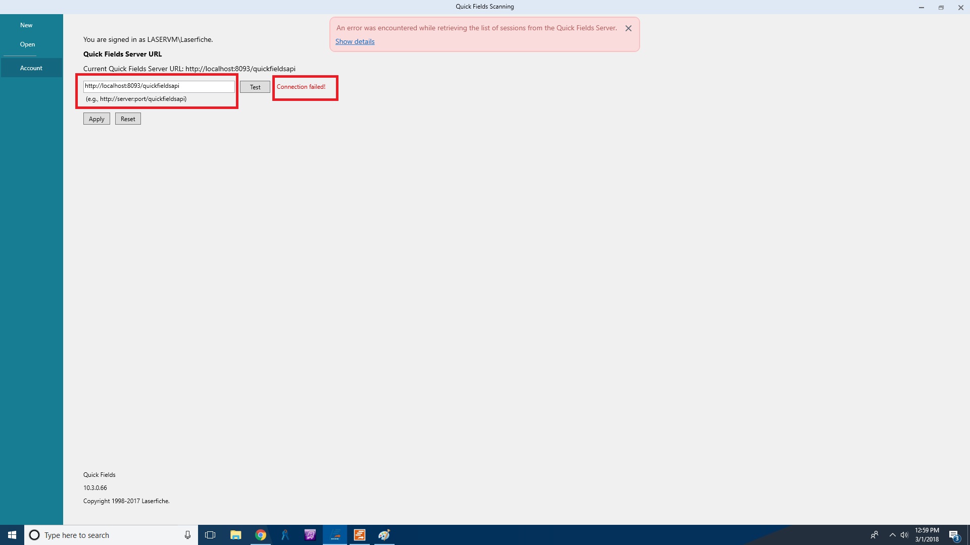

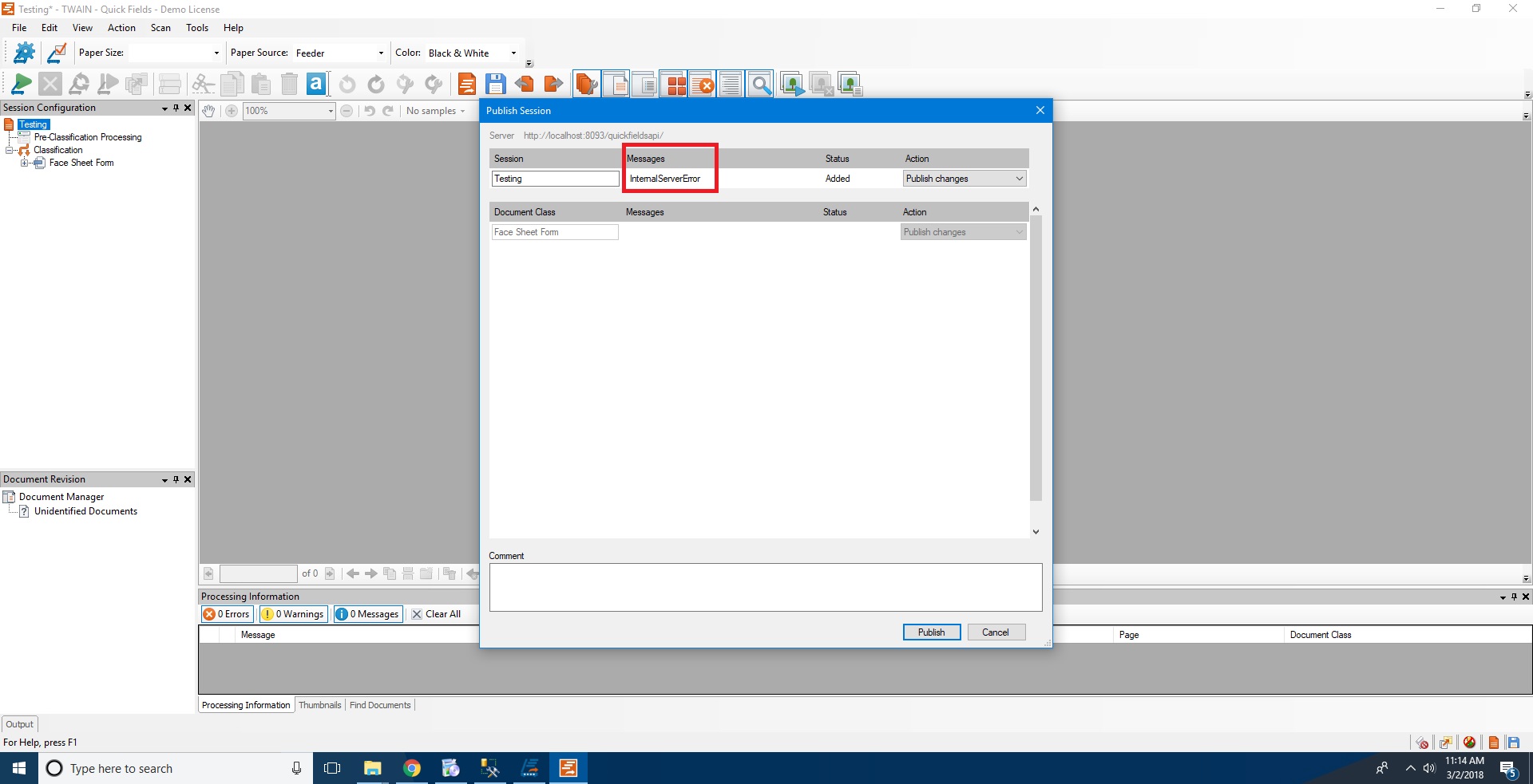

Hi Olivier,
Thanks for your help but the steps described by youi didnt resolve the issue so I deleted the QFS folder from ProgramData and then re-installed QFS manually.
The QF scanning is error free but when I try to publish a session i get this error:
