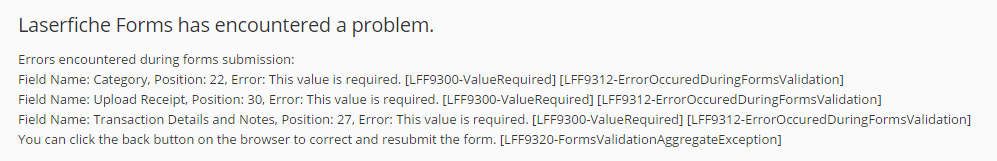

When I tested this with the Submit button in the form preview, it worked, so I changed it to the Reject button and then went to test it in the live processing of the form.
Initially the form appears to accept the "reject" button click, but then comes back with an error.
So it appears that there are two layers of required field validation, and I've managed to remove the required field flags that are used in the first validation (while the form is still displayed) but I'm still catching the secondary validation (after the form has been removed from display).
I'm on version 10.2
Anyone have any suggestions?

Yes, Forms 10.2 added a new backend validation option that is (I believe) turned on by default on new processes. You should be able to turn it off from Form Settings (gear icon), at the bottom.

That was it, thank you so much @████████!
