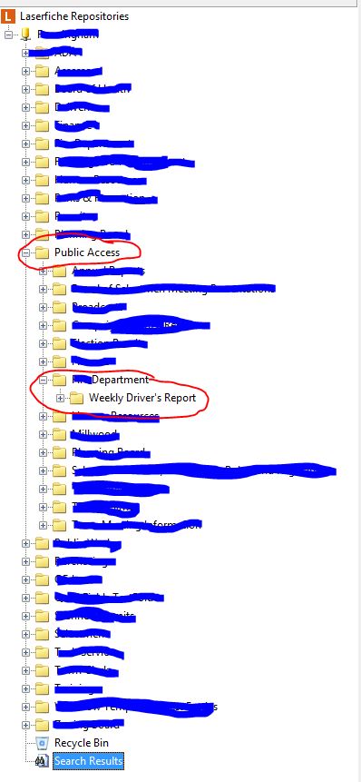

Can you post an image of your file structure, so I can better see what you have going on?
replied on February 14, 2017

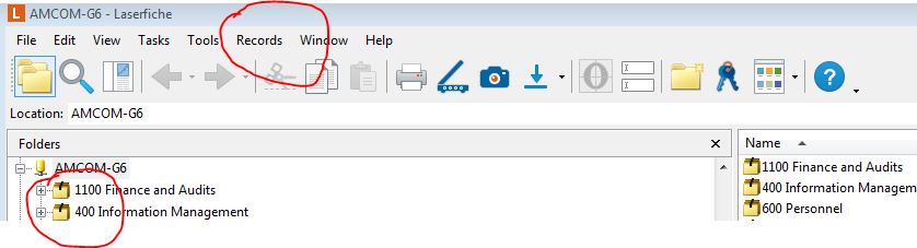

okay... so you have "normal" folders.  To use Records Management (RM) you have to create Records Folders.  they will have brown behind them.   On your toolbar at the top of your client click on "Records" and then "Create Record Series" from the drop down.  See the two circled areas.  One is for the records drop down and the other is what it will look like one you have created one.
I guess I should have said this too.  the Record folder has to be at the top level.  It can't be a sub folder.

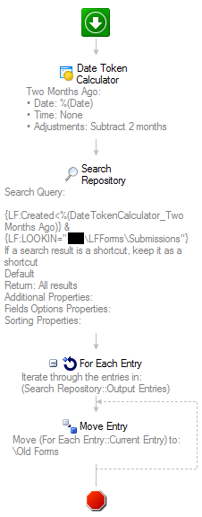

You can use Workflow to search for form submissions in that folder that were created more than two months ago and move those to another folder.
Then you can also have this workflow definition run on a schedule such as once a day or once a week.

Thanks Alexander, that sounds like it would work best for my situation.  So I could do something like  Search Repository-->For Each Entry--> then route entry to folder.
My question is how do I setup the search like I would say for a sql  query "where  datecreated>=getdate()-14"  That would filter anything created greater than 14 days ago every time it ran. Is there some advance search syntax function that would get the current date?
I know the search Repository has the "AdditionalProperties" section, and create date is an option.
replied on February 15, 2017
You can use a workflow like the followoing
Use the "date token calculator" activity to create a token that represents the date two months ago (subtracting two months from the current date). Then search for documents created before that date. For each entry, move it to another folder.
