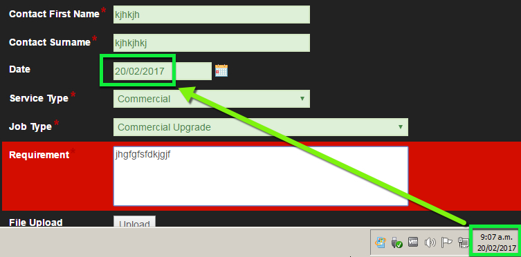

replied on February 19, 2017
Hi Rui,
I've done some more testing and it is to do with the time of day.  Interestingly though, it only looks to be an issue with the "initiated_date" token, "initiated_time" is correct.  Here's the test results:
First I updated the Save to Repository task "Configure Fields" options so that the date field on the form files the "Date Requested" field in the template, but replaced the Job Number field data with the initiated date and time tokens:
I then filled out the form with the screenshot showing the date and time on the server - I am testing directly on the Laserfiche dev server ... sorry about the colours! :o)

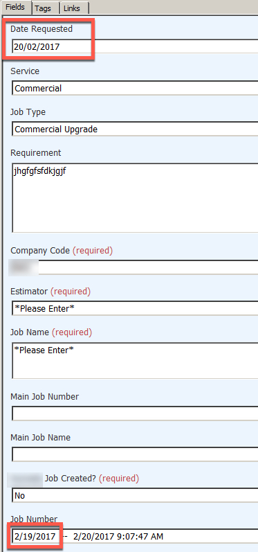

And here's what the result is in the folder template created in the repository, the date field from the form comes through correctly, initiated_time is correct but in US date format, and initiated_date is both a day out and in US date format.  And to confirm, all date settings on the server are in NZ date format, the only US setting is for the Locale for the Forms Router service account, but that account is set to UTC+12:
replied on February 19, 2017 • Show version history
Hi Mike, thanks for your testing! I was able to reproduce the issue that process date variables, including initiated_date, are not correct in certain cases.
This should be fixed in Forms next update. Sorry for the inconvenience again.

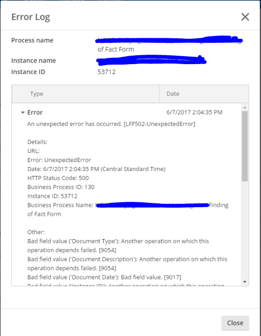

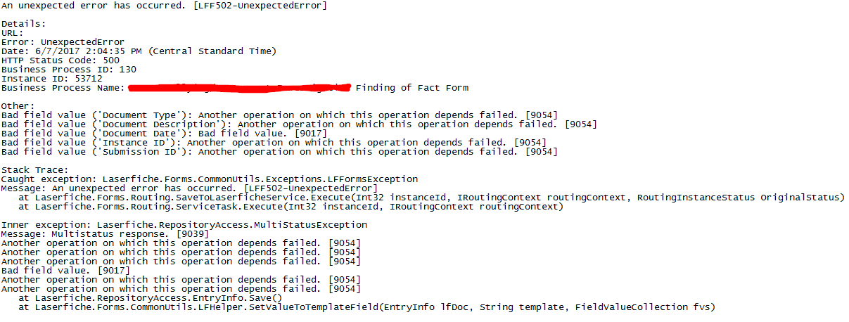

replied on June 9, 2017
Hi, I'm having an issue very similar to this error. And the customer already has Forms v10.2.0.834 (10.2 Update1) and it's still an issue. Any ideas? Please see attached.
replied on June 11, 2017
Hi Peter, can you give more details on the issue?
What is the locale used by routing service run as account? What type of field the "Document Date" field is?
And what is the defined value and runtime value in the "Document Date" field? You can get the runtime value by set the same defined value in a text field.
