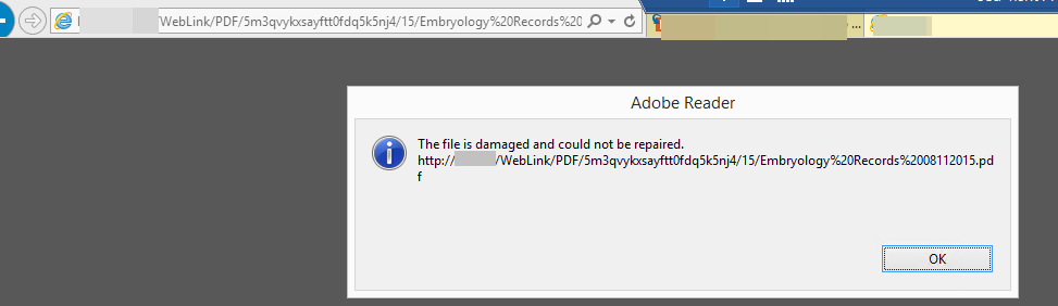

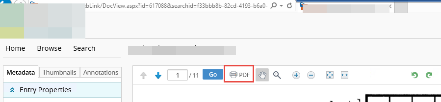

We have Weblink 9.0.0.259, and have installed a firewall (Meraki) for one remote site.
Since then, no users for that sites can generate PDF to print from Weblink.
Same user travels to other remote sites, she can open the same scanned file and generate PDF just fine.
See below screenshots for an example, they don't get any issues at other sites.
Does anyone have clue what ports need to be allowed on firewall to allow users generate PDF from WebLink?
Tried Firefox, Chrome, IE11 but the same result. Any help would be appreciated. thank you

It's not a matter of ports, the pdf download goes over the same 80 or 443 that the rest of the data uses.  More likely, it's a file size limit being imposed by the firewall, or something like that.  A tool like Fiddler should show you the data that's returned, it's possible that the firewall is trying to show an error message but that it's instead being interpreted as the expected pdf file.

Meraki has AMP feature enabled (Adv. Malware Protection), that needs to add whitelist of Laserfiche URL, since then everything started working. Thank you for guiding me to the right direction.
AMP file scanning: the “Malware detection” selector on the Security Filtering page in Dashboard now enables AMP.  When AMP is enabled, downloaded files will be checked against the global AMP database to ensure that they are not malicious before they are allowed to enter the network.
