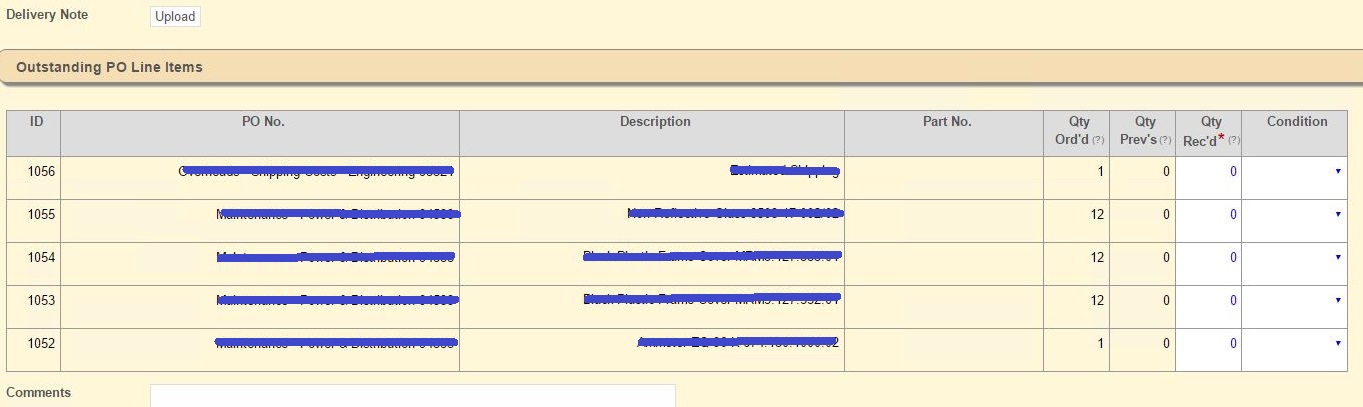

 I have a form which uses a drop down to select an invoice and then uses its name in a lookup to populate a table. If I look at an invoice with six items it is fine as seen below.

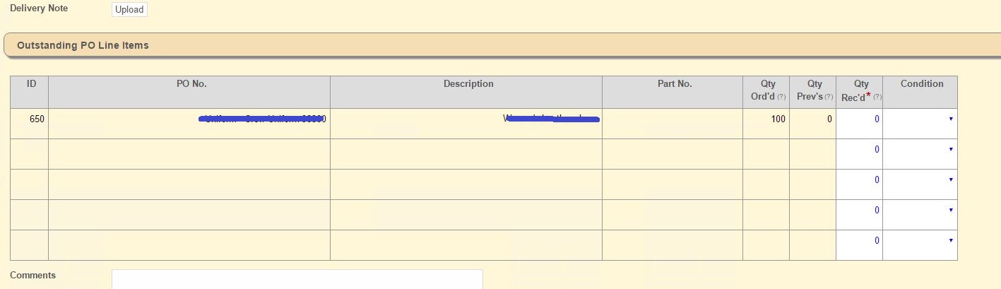

If I look at an invoice with 1 item straight after, the table populates the first row correctly but leaves the last 5 rows from the previous invoice even though they are empty.
