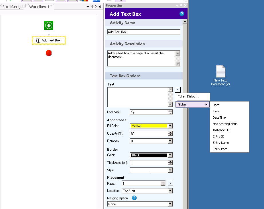

Yes it feasable if you document in laserfiche is a tiff.
in place to use stamp ativity in workflow, you will have to use the add text box activity nad that should do similar as a stamp, and you will be able to use metadata from other workflow activity, like retrieve field value

There's no way for Workflow to intercept the document before it's printed to add the annotation.

oh i have not read properly, it is when they print and not when they scan.
sorry my answer what was not for the time print but at the scanning time.
to get what he want they will need a third party like planetpress from Objectif lune.
this software can manipulate the print stream.
