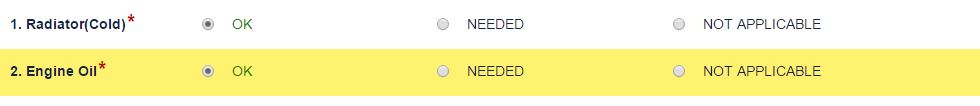

I have a series of questions using radio buttons which consist of "OK" ,"Needed" and Not Applicable".   I would like to change the color of the text based on which radio button is selected.
I would like the following:  change the color of "Ok" to green if it is selected,  red if "Needed" is selected, and leave "Not Applicable" in black.
I know how to use CSS to change the color of the text but not 3 different colors based on what radio button is actually selected. I am guessing I need to use Javascript here to enforce the logic.

Thank you for your reply Yoonsang. I inserted the code into the Javascript section of the "CSS and Javascript" tab and replaced  #q1 with #q27 which was the radiator question ID from my uploaded image.
I saved and yet when trying to preview or actually run the form there doesn't seem to be any color change when clicking on the radio buttons. "Ok" doesnt turn green and "Needed" not turning red etc..  Is there something else I also need to do to get this working? Something I may have missed?

For the first question that was my mistake, after changing them to "ok" "needed" etc.. that worked.
I was looking to have the word "OK", "Needed" and "Not Applicable" change to green, red and black.   Is that possible? You have been a big help!
