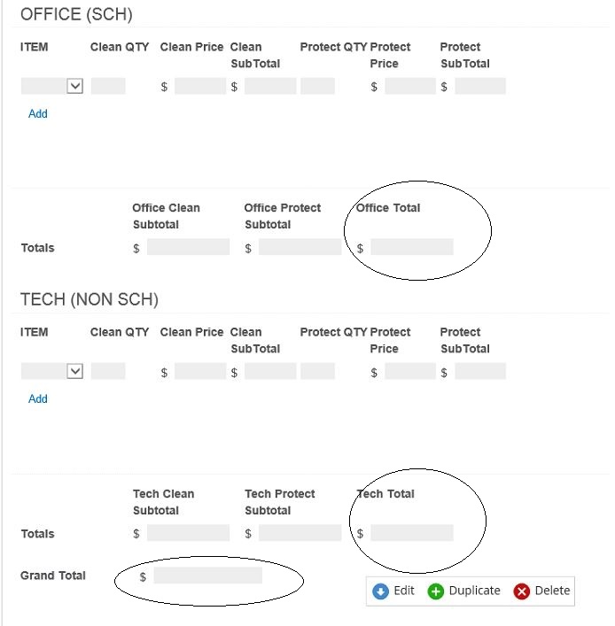

Hi All,
I am trying to add together 2 fields that are in separate tables to a currency field out side of these
I have attached a image of how the form looks, trying to ADD Office Total and Tech total together and be populated in Grand Total
I have Scripting around all the other fields that are working perfectly
I have tried using the advanced calculation with :-
=SUM(variable_2.Office_Total,variable_3.Tech_Total)
This creates a 0 amount in the total but never changes
I have tried adding the same CSS (grandtotalsub) to Office Total and Tech Total and then the CSS (grandtotal) to Grand Total
I tried this javascript
    $(document).on('blur change', '.sum input', sumtotal);
    function sumtotal() {
        var s = 0;
        $('.grandtotalsub input').each(function () {
            s += parseNumber($(this).val());
        $('.grandtotal input').val(s);
    function parseNumber(n) {
        var f = parseFloat(n); //Convert to float number.
        return isNaN(f) ? 0 : f; //treat invalid input as 0;
What am I missing or need to change?
Regards
Shane
LF Issue.JPG (67.65 KB)

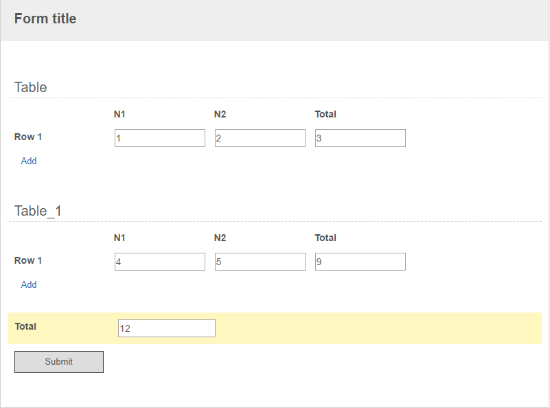

Hi Shane,
I created a test form and this is how I have it configured.
The first table total calculation is: =SUM(INDEX(Table.N1,ROW()),INDEX(Table.N2,ROW()))
The second table total calculation is: =SUM(INDEX(Table_1.N1,ROW()),INDEX(Table_1.N2,ROW()))
The total field calculation is: =SUM(Table.Total,Table_1.Total)
Thanks,
Michael
replied on February 1, 2017
Hi Michael,
That should work but for some reason isn't,
Now what I get is a 0 Amount against the Office total and the Tech Total.
I was using Java for this which is working (I did take the scripting out so there wasn't Calculations and Java running together)
I am wondering if because I am using Javascript for sending data to the Office Clean SubTotal and the Office Protect Subtotal (and the tech totals) that this is causing an issue?
I used this
=SUM(INDEX(OfficeTotals.Office_Clean_Subtotal,ROW()),INDEX(OfficeTotals.Office_Protect_Subtotal,ROW()))
=SUM(INDEX(TechTotals.Tech_Clean_Subtotal,ROW()),INDEX(TechTotals.Tech_Protect_Subtotal,ROW()))
=SUM(OfficeTotals.Office_Total,TechTotals.Tech_Total)
