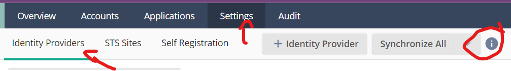

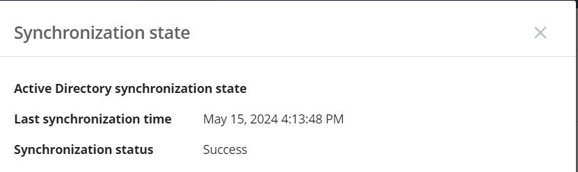

The scheduled AD sync should be updating user information, as far as I am aware.
You can check the status of AD updates here:
I would open a support case if, after AD sync runs, you do not see updates to user profiles.
There are no near-term plans to change the functionality. The essence of the issue is that AD doesn't send a notification to LFDS, so we cannot automatically detect changes, and thus we update it either (1) when AD sync runs and LFDS queries AD for the update information or (2) when the user logs in.
replied on May 24, 2024
Hi Briana
The AD sync runs and is successful but the profile data is not updated.  I've verified that the users are not marked as exempt as well.  I'll open a support ticket.
