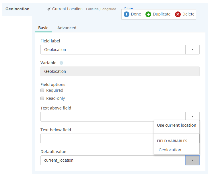

In the Geolocation field options, you can set it to a Default Value of current_location as shown in the image below:

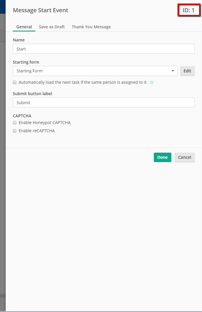

where the 1 corresponds to the ID of the process event which can be found in the Process Diagram by double clicker a step as shown below:
And  the "#q4" is the id of my geolocation field.
