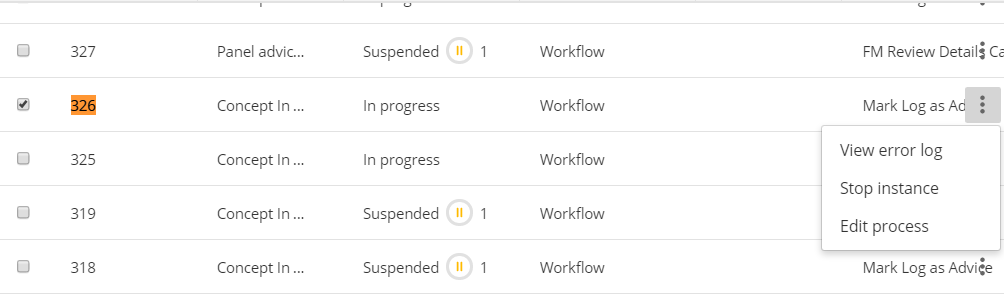

I can see a couple of other forms process instances that are in suspended state because their Laserfiche Workflow terminated. I can retry and get them working but 326 in the below pic. I can resume suspended ones by retrying but 326 has no retry option.
The reason for termination is we had a runaway process which caused the workflow server to run at high CPU for a short period and might have terminated some of these Laserfiche workflows which were at the time in a wait/pause activity.
Is there a way to advance a Forms workflow when the retry option is not shown ?

There's not enough information to troubleshoot. Workflows waiting for user action are not likely to terminate under high CPU conditions since they're already persisted in the database and not actively running.
When a workflow instance is terminating, that's communicated back to Forms.
It's probably best that you take this to Tech Support so they can track down all the logic of this process.

No, unfortunately there is no way to fix this issue. I contacted LF support and they confirmed it.
I have added better error handling steps in the workflow and have developed additional workflows to kick things off from where the error had occurred.
