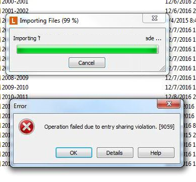

I have a customer that is getting the "Operation failed due to entry sharing violation. [9059]" error during PDF import processes if they select to generate text during the import.
Any ideas as to what is causing this?

This should be fixed in the latest 10.1 LF server (bug# 136436).

Hi I have the same issue.
I did upgrade to Server 10.2.1 but that did not help at all.
Anything else I could check?

If I remember correctly, the problem was that the PDF was in a format that the 3rd party DLL used by Laserfiche did not support.
