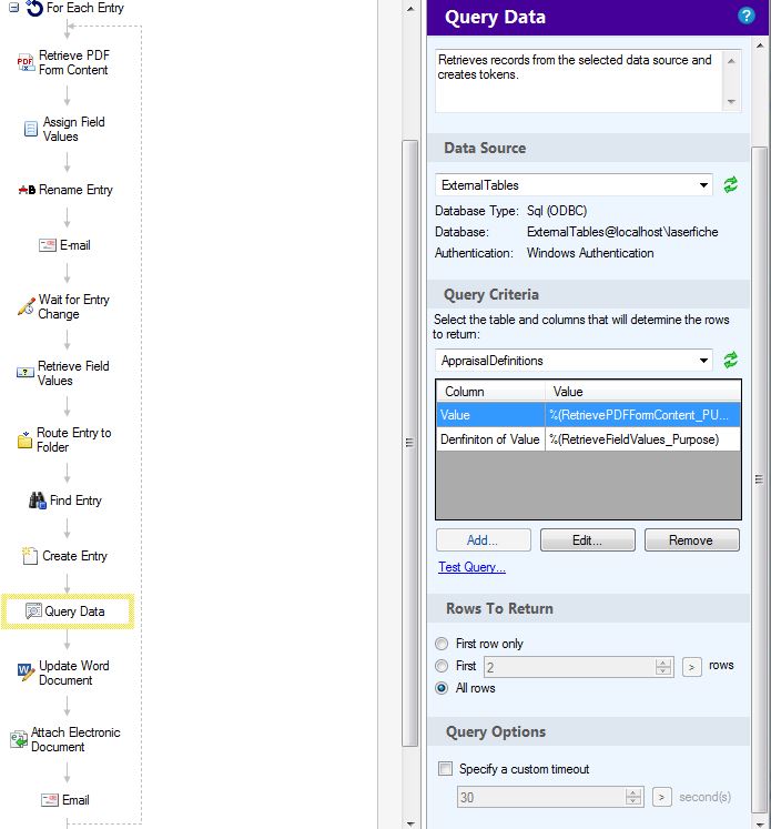

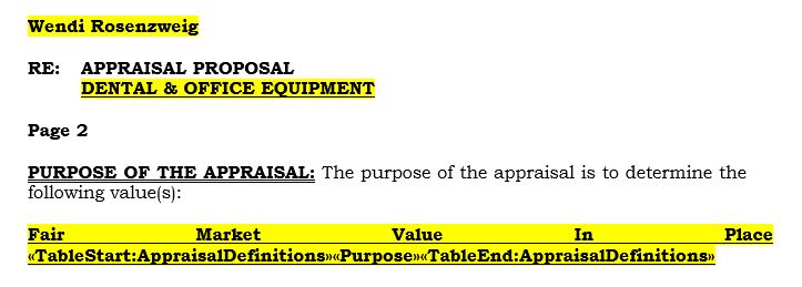

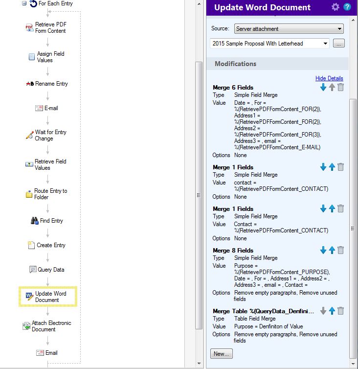

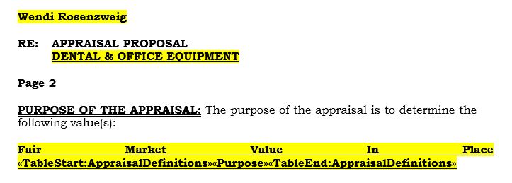

I am able update a word doc with MergeField no problem.  But now the same word doc needs updated from an external table. I created the table and added it in the Admin Console and edited the Word doc added StartTable and EndTable. However it does not seem to be pulling from the table. My merge fields are being updated but nothing in the Table. I will attach screen shots of my workflow and word doc. Any input would be appreciated.  Thanks Wendi

Can you add a screenshot of the table merge setup?

replied on January 20, 2017
The stuff in yellow pulled in the correct info except the TableStart:AppraisalDefinitions  Purpose  TableEnd:

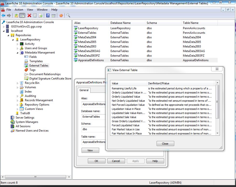

Attached is the excel file I used to create a cvs and added it in SQL and the Admin console external tables.
I am updating the word doc with fields I pulling from a PDF, but I thought with query data I needed to add the external table. Is that correct? Thanks for your support. Wendi

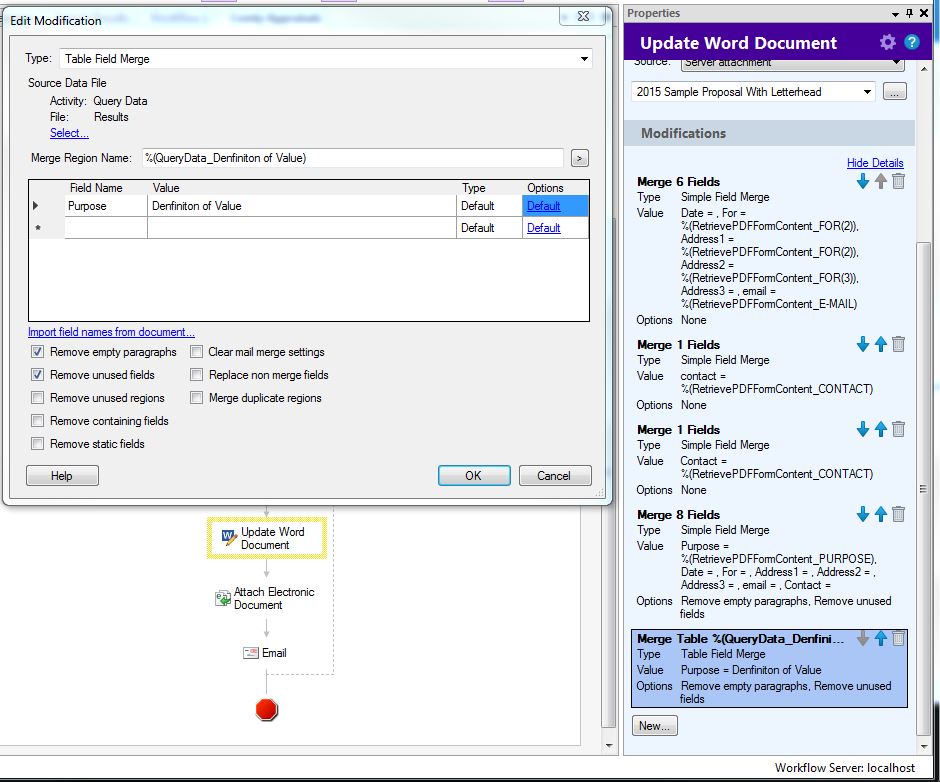

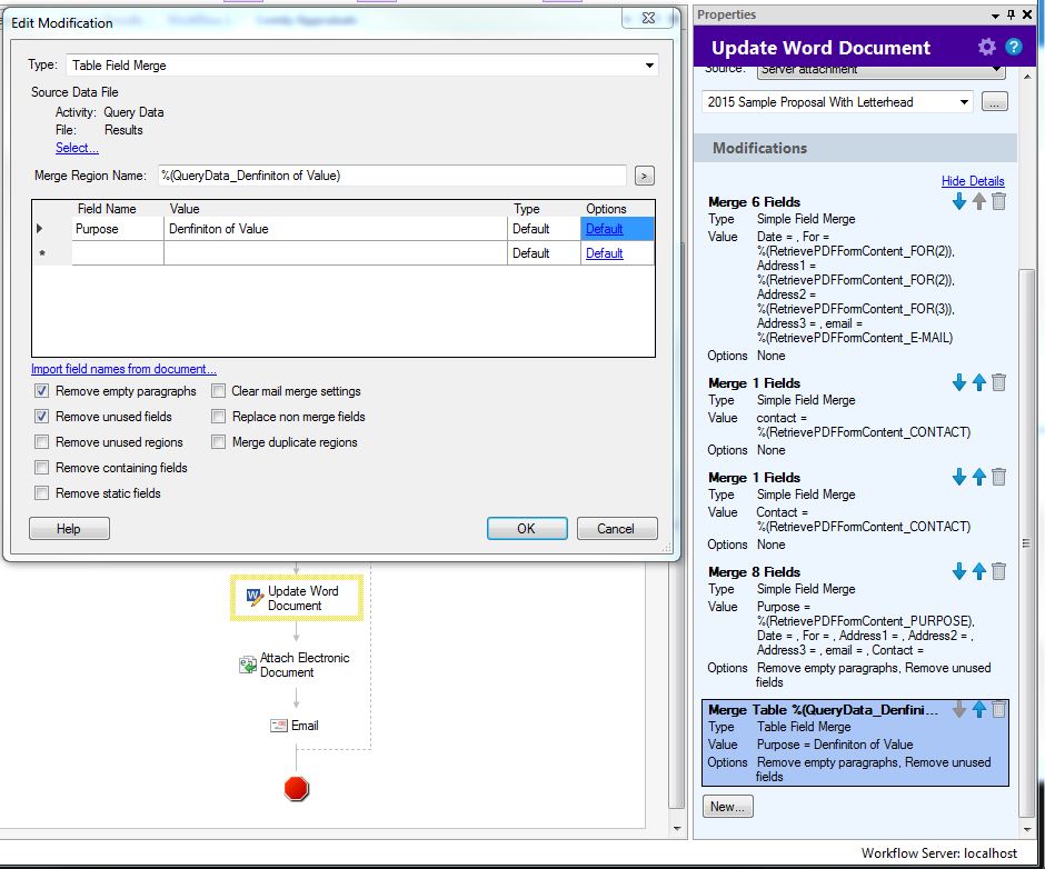

Sorry, I meant the table merge action from the Update Word Document activity in Workflow.
replied on January 23, 2017
attached.  Thanks

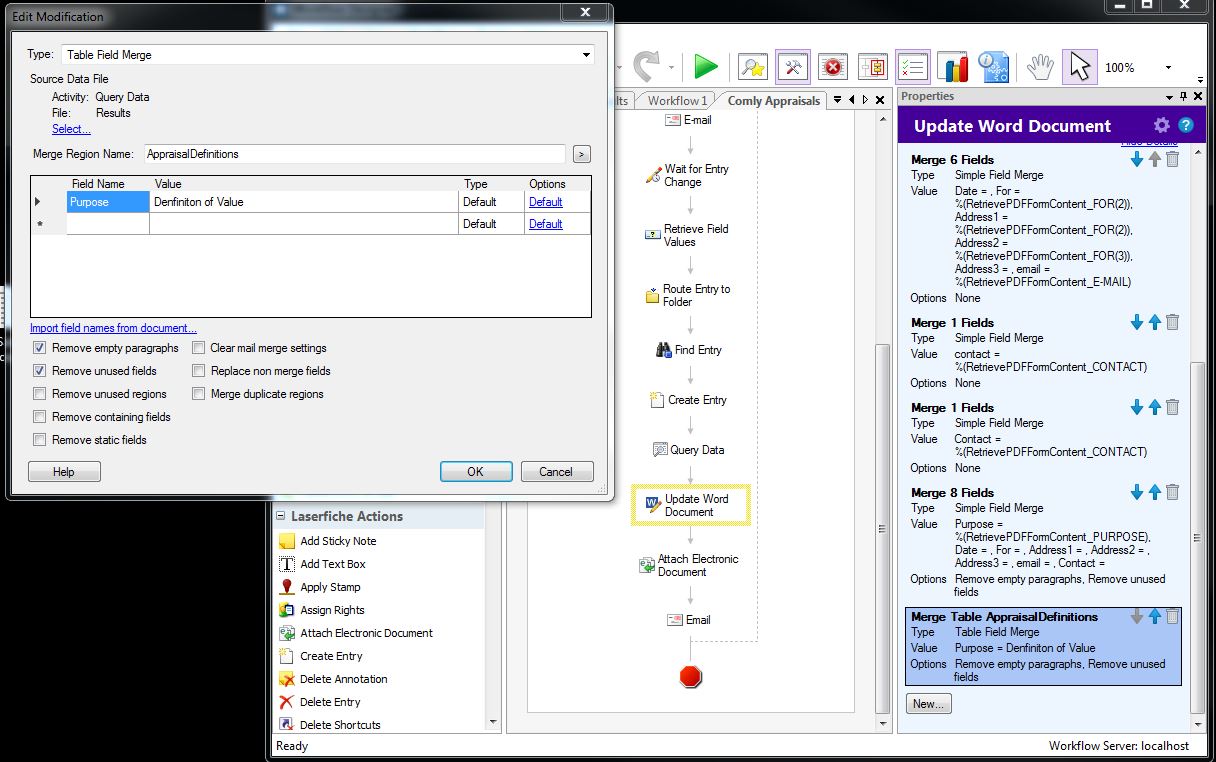

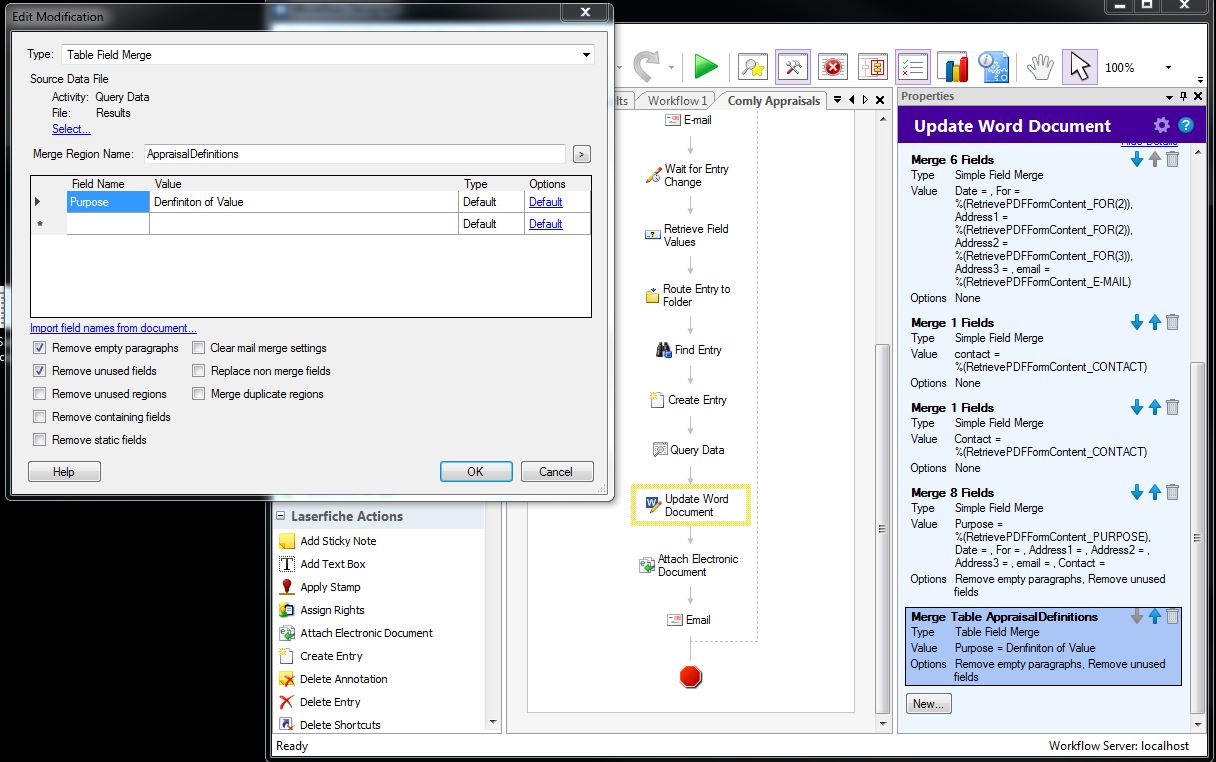

Your "merge region name" should be the same as your table name: AppraisalDefinitions

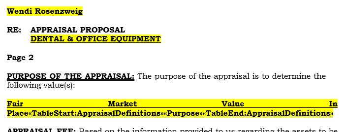

I made the change, republished the Workflow and get the same result. Did I miss something? Please advise.  Thanks
word doc.JPG (39.58 KB)
