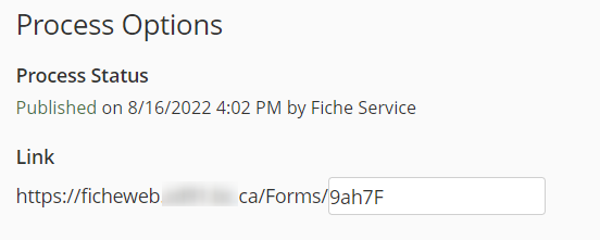

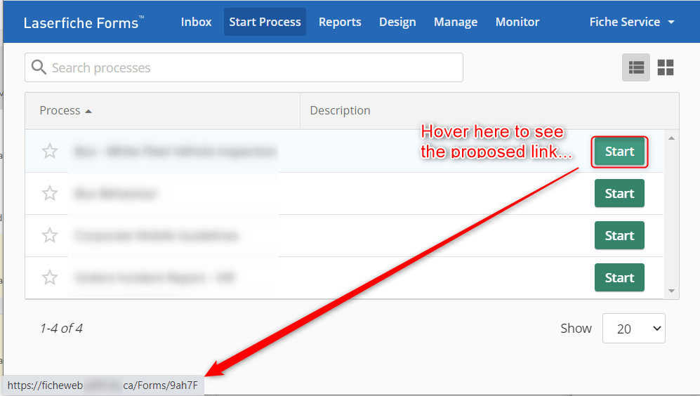

replied on August 17, 2022
Sorry to dredge this back up from long ago. Hoping a dev can respond...
Why is this the behaviour?
If I don't use a message start event I can still hover over the "Start" button on the "Start Process" page and see how I could link to the process.
What is the purpose of not allowing me to customize that address unless I use a message start event?
If I do change the process to have a message start event, it gets the same default link so I'm not sure why we are being forced to only use one kind of start event.
I'd like to start a process by having a QR code users can scan to take them to the process, but I don't need to start it with a message start event.
Any insight would be appreciated.
