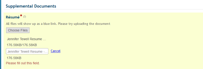

I am having trouble with people trying to upload their resumes to an application form. It almost fails when it finishes the upload. It works sometimes but sometimes we have to try to upload several times for it to work. Anybody else experiencing these problems?

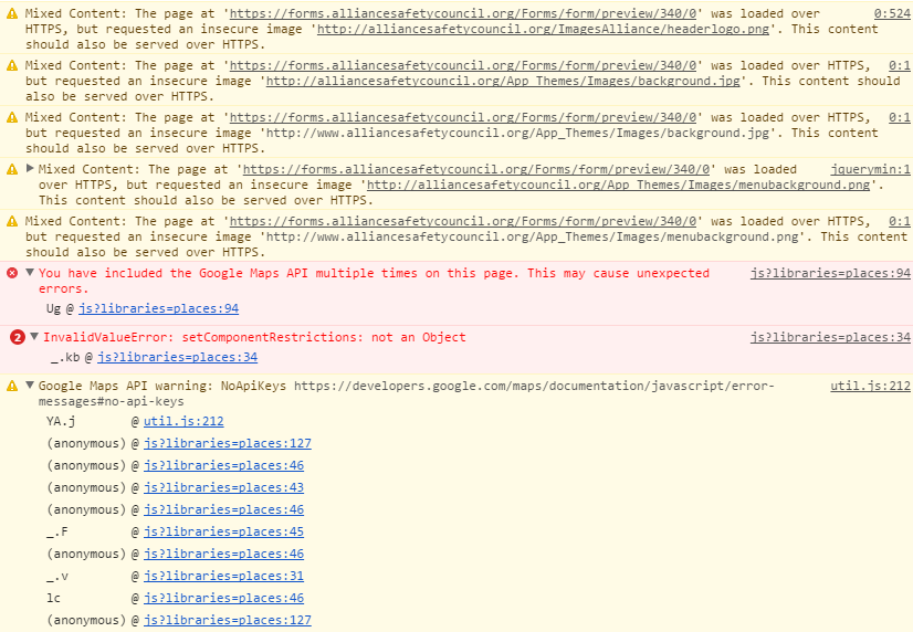

The error you posted is not related to the upload issue. Please check whether there is any error in the debug console from developer tools of the browser.
replied on January 12, 2017 Show version history
I believe this is what you wanted. I don't see anything that relates to the upload issue though.

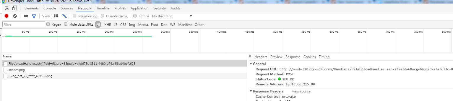

You can check whether the issue will be solved after you fix the JavaScript error. Also you can open the Network tab for Chrome Developer Tools and upload the resume and check whether the request start with "FileUploadHandler" will get Status Code 200 OK. And what the response if it get any error.
