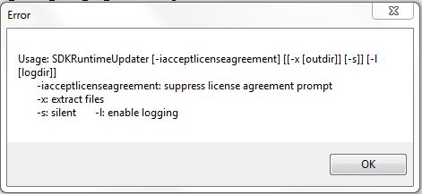

I'm attempting to include the LaserficheSDKRuntimeInstaller.exe in my deployment project. I've always used the Merge Modules in previous projects, so I'm not familiar with this way. I'm running into an error, which I attached, during the project installation. I included the LaserficheSDKRuntimeInstaller.exe in the Project's File System, and created a Custom Action for it. I tried with and without the parameters listed below.
LaserficheSDKRuntimeInstaller.exe -iacceptlicenseagreement -s
Can anyone explain in more detail than the documentation on how to include and run the LaserficheSDKRuntimeInstaller.exe this way?

It can be tricky to correctly pass command line parameters with Custom Actions.  If you're not careful, you could be passing the exe name as the first parameter.  A tool like Process Monitor is useful for this, you'll want to look for the Process Create event that attempts to launch that exe.  You might also be able to see the command line in the install log.
